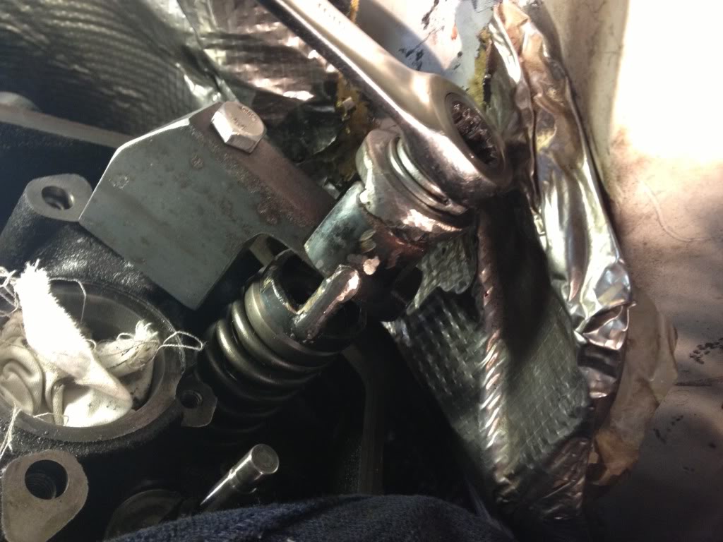

Here is the one I modeled after the OTC/Rotunda tool. You don't have to remove the injectors to use it, but the member that borrowed had his out when he took the picture. I still loan it out to other members. Just PM me for shipping details and such.
Name:  McTool in use.jpg
Attachment 187160
the best way to go! each time i can i also build my own
