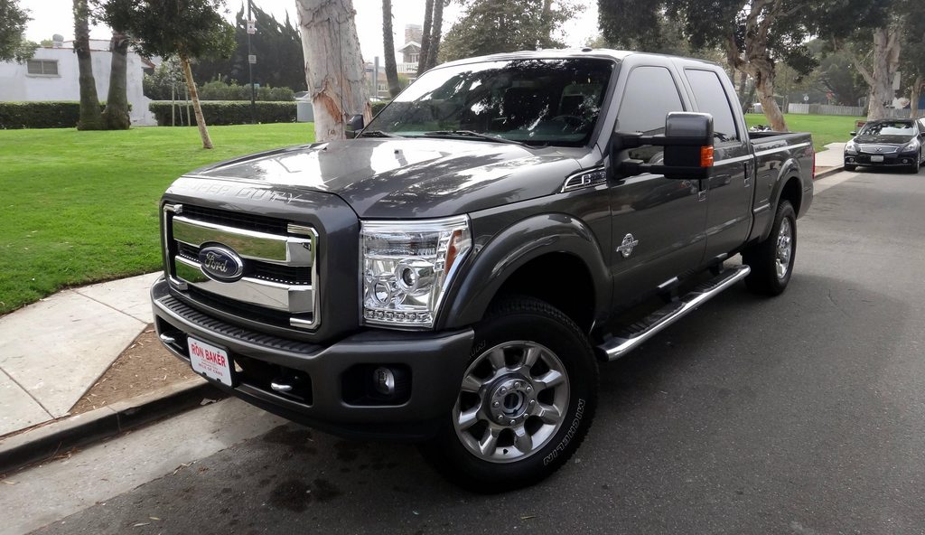

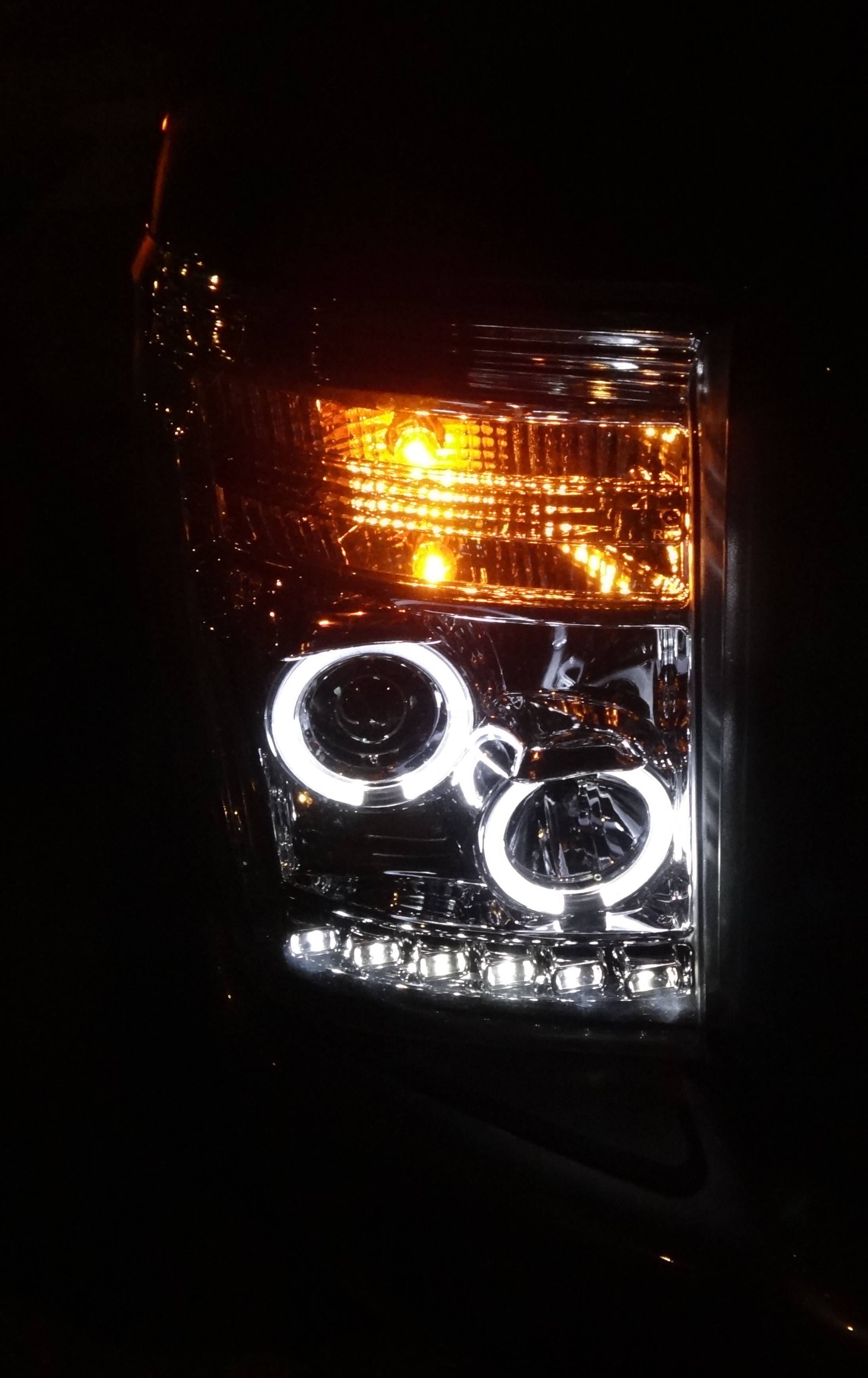

Just something to keep in mind.
If you go to change the lights to LED's or HID's, you need to change the housing to suit, as the reflector beam pattern needed is different. Running LED's (or HID's) in housings designed for halogen globes (even if they fitted) results in poorly dispersed lighting, and often can blind oncoming traffic - and is definitely something the cops can pull you up on.
Even a cheap set of LED spot lights will work much better than a set of LED's in a halogen housing.
I have also seen some people get a complete HID housing and install it inside a halogen housing for quite good results.
I (like everyone) found the lights to be crap in these trucks, so I changed out the housing assemblies (has LED's for park lights and HID's for Low beam), not a cheap exercise, but an effective one.
Attachment 291670
Attachment 291671
You will notice the housing looks entirely different than the standard housing.

Adrian. You are really rubbing salt into our wounds posting up pics like that . That is one sweet looking truck. Sooooo jealous.
