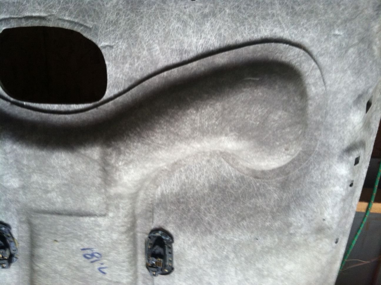

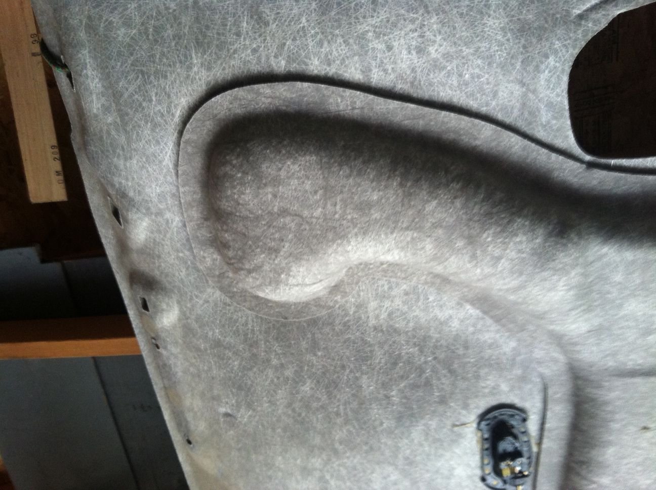

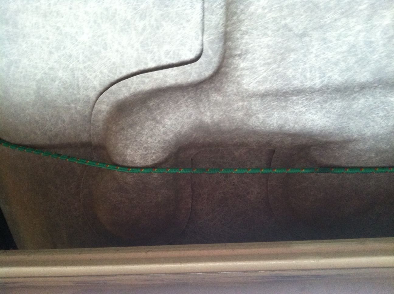

I have recently removed the liner from my parts truck it is one big piece the seats and a few trim pieces have to be removed to allow the angle needed to get it out the back door. I tried with the seats in it was a no go. I removed the fronts first not enough then the driver rear hit the steering wheel then last passenger rear then it was able to come out. It was tight but doable. 2nd on the back side where the "ducting" runs is fiberglass also glued to the main liner so your repairs from the rear may be more than you think. I have the liner hanging in the garage I can get a photo of what I'm talking about when it is done raining

the photos are not super great but it shows all areas of the "ducting" on the back side. im pretty sure trying to remove it will lead to more damage than wanted. maybe you can do the repairs through the hole and reshape the opening when your done filling it

Oh I see. Thanks for the pictures, those are just fine quality. Yea I don't think I'll seperate, I'll have to find a way to fix them without it. Thanks again!
