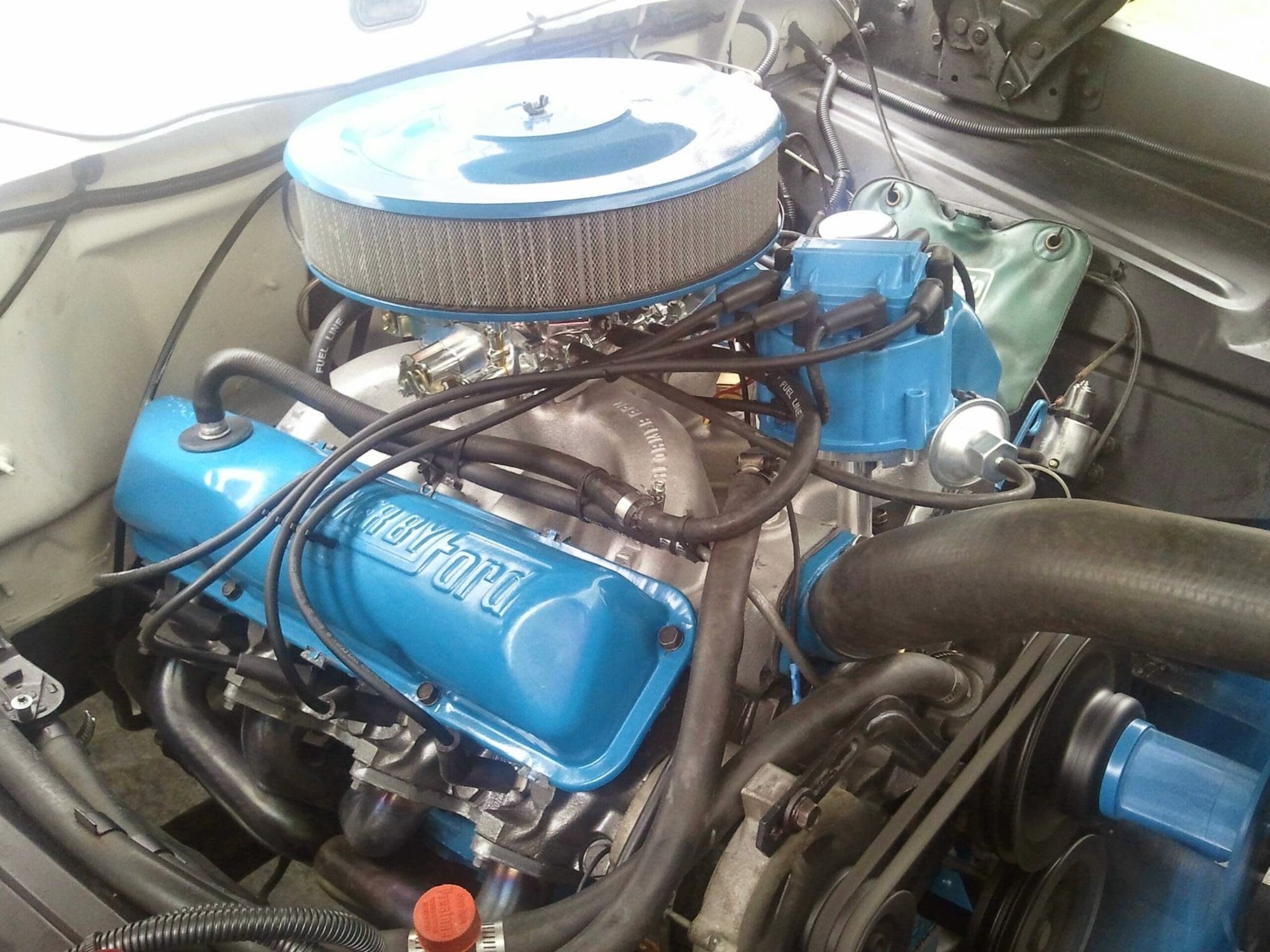

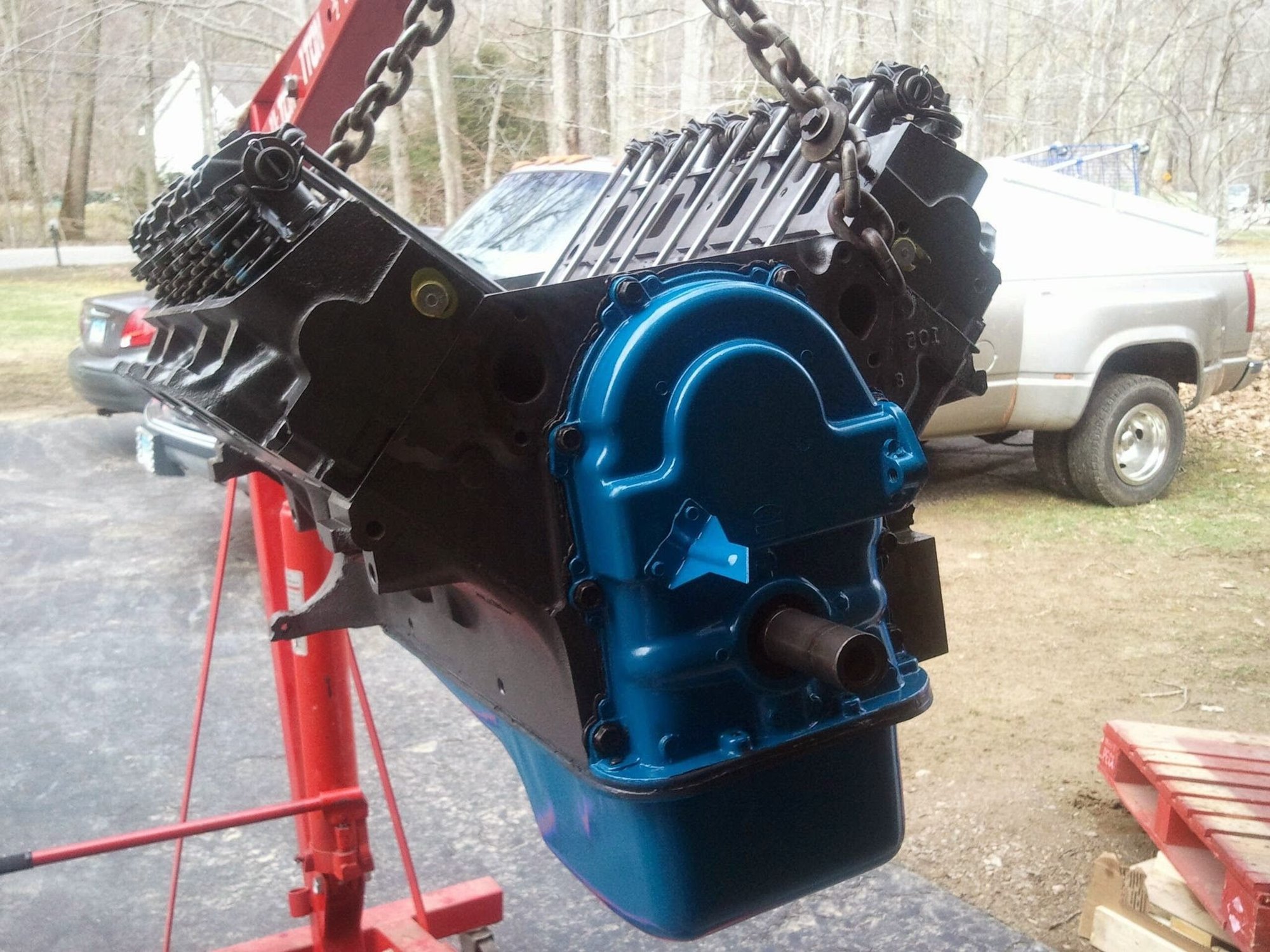

New long block - FE390 (real deal)
Sounds as good as it looks, Sanderson headers and dual dumps after Cherry Bomb Vortex mufflers...
got rid of cast iron monster manifold and picked up a remanufactured edelbrock 4bbl carb.
Yup, that's 4 brand new snow tires and cheesy Pep Boys hub caps for $60... that's a sin...
Truck came from California, rebuilt in Connecticut, now resides in Texas - seen more of the country than most people...
