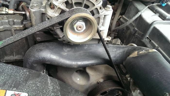

Here's a picture of what I was seeing after I pulled my trailer home, I opened the hood the next day and saw this. Why would it do that to my upper hose? I loosened the clamp up and it started to draw air in and the hose expanded back to its normal shape.
To those who have mentioned the fan clutch I agree, my clutch has been suspect for awhile, it has never locked up when the motor was hot. It only locks up first thing in the morning when I start it, so I have a new one that I have yet to install. I just wish I could rule out the radiator in the mean time
Last edited by fbh31118; May 28, 2014 at 09:54 AM. Reason: Forgot to mention my clutch

This is exactly like mine but I just changed my tank and cap about three weeks ago, unless it was a bad cap from the factory.

Were you having the problem prior to changing the Cap?
Do you have you're old Cap?
For the $20 Bucks I'd try another OE Cap. Or just exchange the one you have from whomever you bought it from.
Please keep posting. Like I said, these things rarely have cooling issues, so my curiosity is elevated.

Yes, I was having problems before hand but not the collapsing hose issue. My tank came with a new cap but I ordered an OE one along with it that I can swap out.

I'm wondering if it's building up pressure when it gets hot and then when it cools down it is collapsing the hose and the cap can't release enough of the vacuum? Or does it do that with the engine running?

I'm not sure if it is doing that while running but after I opened up the hose clamp it drew in air. I'm hoping that having the radiator tested will reveal something.
