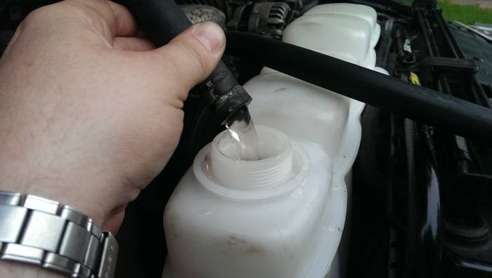

By what method, test, tool or gauge do you verify water pump flow?
This picture shows the coolant return line coming from the heater core to the top of the pump. In my mind this proves very little other than there is some flow coming from the water pump. This by no means RULES OUT a water pump (or any other problem for that matter) in my mind. Just more information.
In case anyone is wondering I'm just running water till I get this figured out. Got tired of wasting money on coolant just to dump it out again and start over.

Yup, new fan clutch installed, planned on picking up another t-stat from Ford tomorrow. This thing has already blown a hole through my lack luster budget, mys well spend some more. Can't afford to shoot the damn thing.
I think your plan to change the t/stat is a good one. I don't know of any flow test for the water pump, but that doesn't mean none exists. I suppose you could use long pieces of hose from the t/stat outlet and pump inlet and route them into a large, low pan of some sort full of water and see how much flow you get when the t/stat opens. Seems like a real pain to go through all that though. There's also the possibility of getting burned in the process . . .

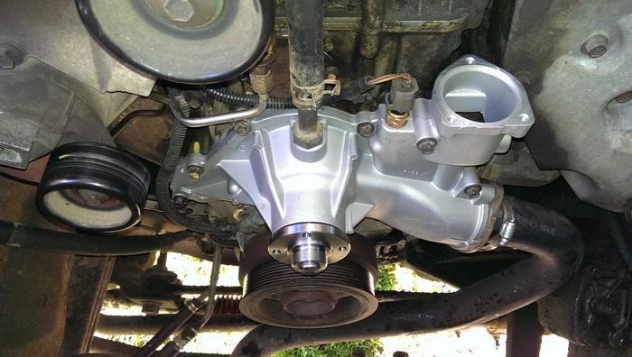

The final installment of 'Still having a cooling problem'
Finally got a chance to pull the pump out to see whats going on. The pump and its impeller were intact with the exception of the cover plate on the pump had warped which lead to the impeller being worn down. It didn't look bad enough to cause an overheating problem so I'm guessing that the thermostat had something to do with it. I know the t-stat opened but I'm wondering if it some how was not closing the bypass as some one had mentioned about the short t-stats in these pumps. After putting about 80 miles on it last night I'm pretty confident that every thing is working together again as it should, although, I'm going to buy a new fan and install later.
