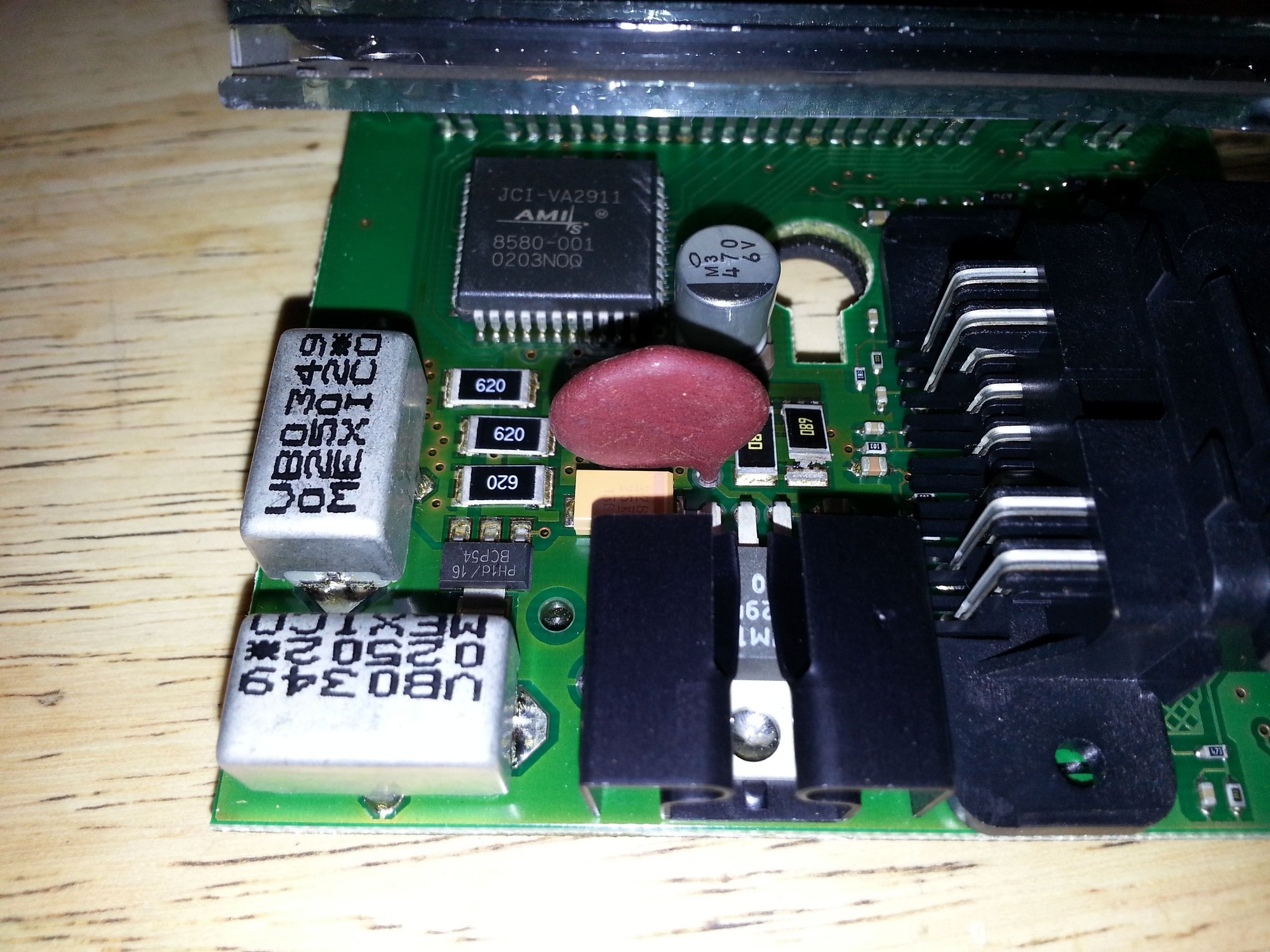

Was running some wires for guages and GPR LED and decided to pull my PCM to check the code for when I get a Chip in the future. Looks like it has had a chip at some point and wondered about the contacts. They look a little worn to me.
What do you guys think? Thanks.

I would try the chip first. It looks decent, not great, to me. If it doesn't seat, then get it re-tinned.

You don't want exposed copper - it can corrode and turn green with time/humidity. I would tin the connector, then solder-wick it to keep it flat and even.

Depending on the chip it may be a surface mount that needs to be re-flowed. Does the chip have legs does it just have metal showing on the sides?

Just metal on the side. One side is still attached.

Take a picture of it if you can it sounds like a surface mount that needs to be reflowed. Can be done with iron but easier with a reflow heat gun.

I agree for the re-tinning to use a good iron I was referring to a re-flow gun for the overhead console chip because the way he described it it sound like one of the surface mount chips. I use small tips 3mm-6mm on my reflow gun for alot of my surface mount components.

Here's A pic Bigbee.
