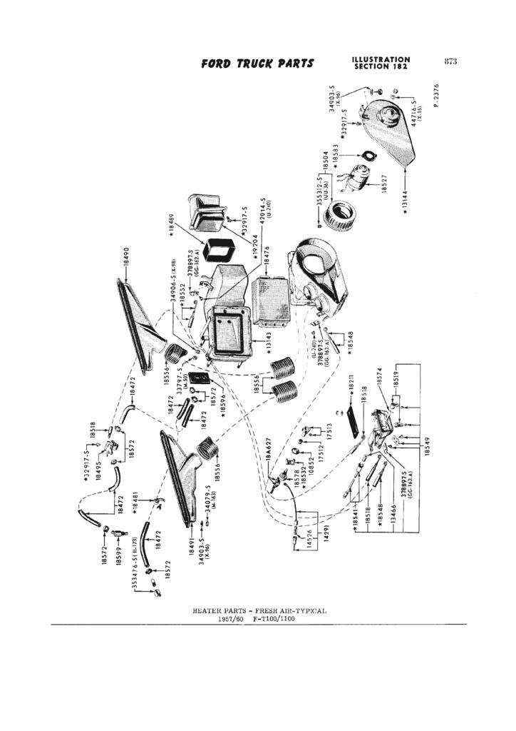

1957/60 F100/1100 ~ Two different heaters: Fresh Air (left) & Recirculating (right).
B7TT-18476-A .. Heater Core...is the same for both. But this doesn't mean that the heater core you're trying to install...is correct.

Thanks for the diagrams!
The heater core and is what was in it when I got the truck, I have it so the hoses connect up good with no kinks
