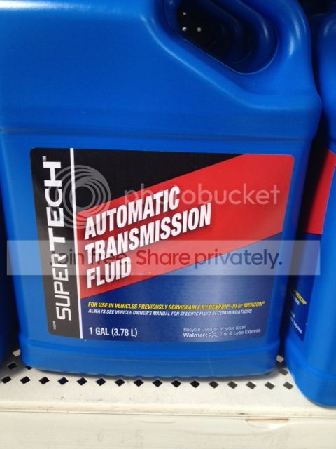

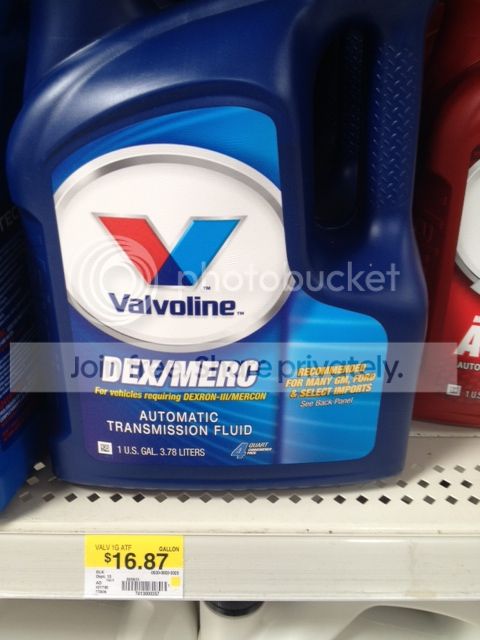

The pics below are the two trans fluids sold at my local Wally World. One is Valvoline™ and the other is the Wally brand, Super Tech™. These are the only two I can find that reference being acceptable as a Mercon® replacement. My dipstick says use Mercon®. If these in fact are correct based on Ford documentation, is the Valvoline™ much better than the Wally brand, Super Tech™?

So, it would not be those pictured? Those pictured state to use where Mercon® is specified but NOT where Mercon®V is specified.
My owner's manual states to use Mercon®. All I can find is Mercon®V besides those that are pictured. I can not find the plain Mercon® only the V stuff.

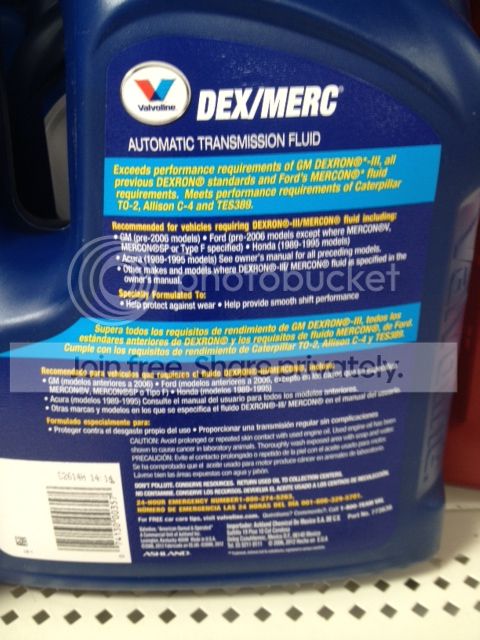

and if you look closely at the wallyworld bottle you will see it is made by vlavoline, and is the same thing only without the valvoline name.
Tom, I'm looking closely but don't see the reference to Valvoline

it used to say something like made by or packaged by Valvoline exclusevly for walmart on the bottom of the bottle.
