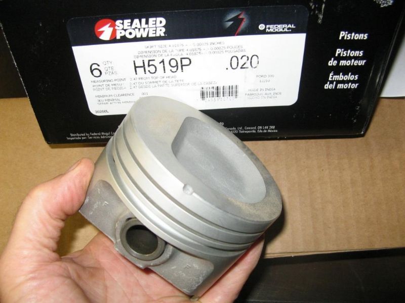

Below is the OEM piston. The dish is rather large. Flat tops obviously eliminate that dish, raising the compression a lot. If I recall correctly, flat top 352 pistons in a 300 work out to just over 10:1 static compression. The RV cam probably gives you a high dynamic compression - again, requiring high octane.
Secondly, yes. You can machine whatever you want, but piston material is important. Eutectic, AKA cast pistons aren't all that great for machining because of the sand content. Forged or billet can be machined all day long. So, yes, you can machine 0.020" off the pistons.
