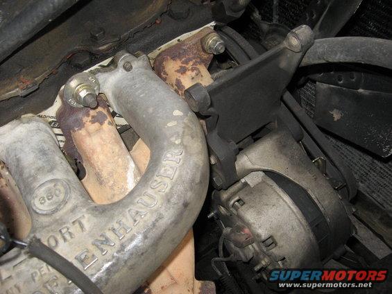

Does anyone know if there will be any clearance issues with the efi manifolds on an e150? The alternator bracket curves around the log style manifold and I'm not sure if the efi manifolds would clear it.
That's the alternator bracket from my original log manifold setup. There weren't any fitment issues.
As for going into a van, I don't see why not, but I've never done it.

Abandonedbronco, your alternator bracket is different from mine. I read that the bracket needs to modified or replaced on Econolines when using aftermarket headers, so I was wondering if the same is true for the efi manifolds.

Ok, I wasn't sure if they were all the same. Either way, it should just be three bolts to unbolt one bracket and put on another. May have to scrounge it from a junk yard.
