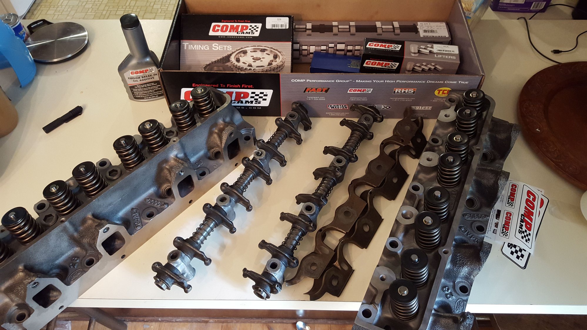

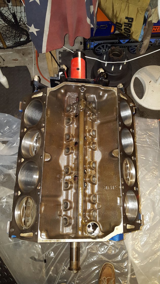

Comp 268h cam

I know it's a little late but did you have hardened valve seats installed?

Yes they put new seats and guides in there. I have a good machine shop so I just Gabe him the heads and told him what I was doing and he ordered the cam kit and built around it. He also did the block. But now I can't find the rocker arm bolts and I am pretty sure they were on them when they went to the shop. Any idea where to get new ones. I know two of them are special.

I got the bolts from the shop. They are hard to find.

only the tapered "oiler" ones

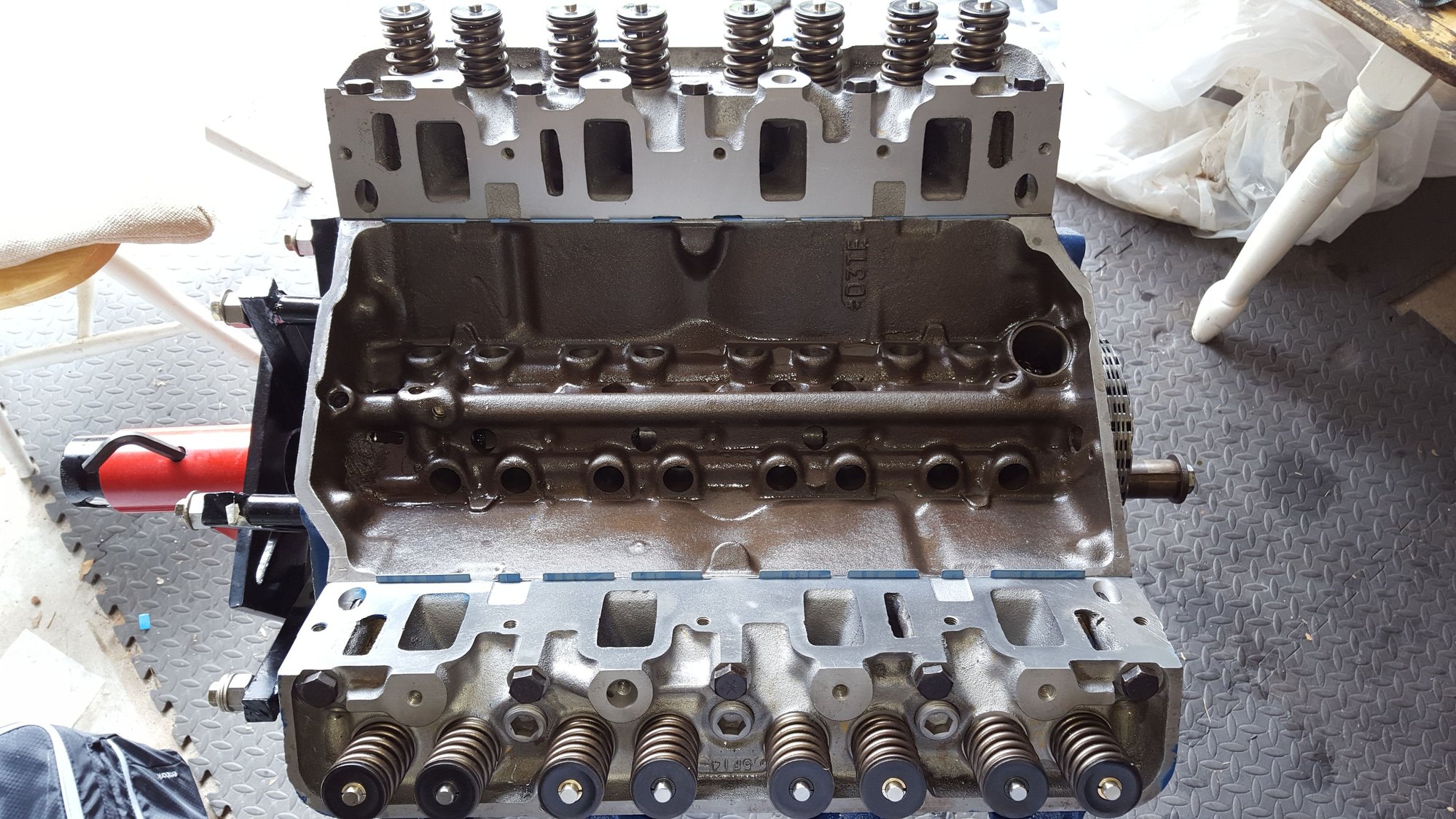

Ya just those are hard too get. I just spent about three hours on the intake. Cleaning and filing. I think it's flatter than from the factory now.
I almost didnt remove this pan. That would have been really dumb.
