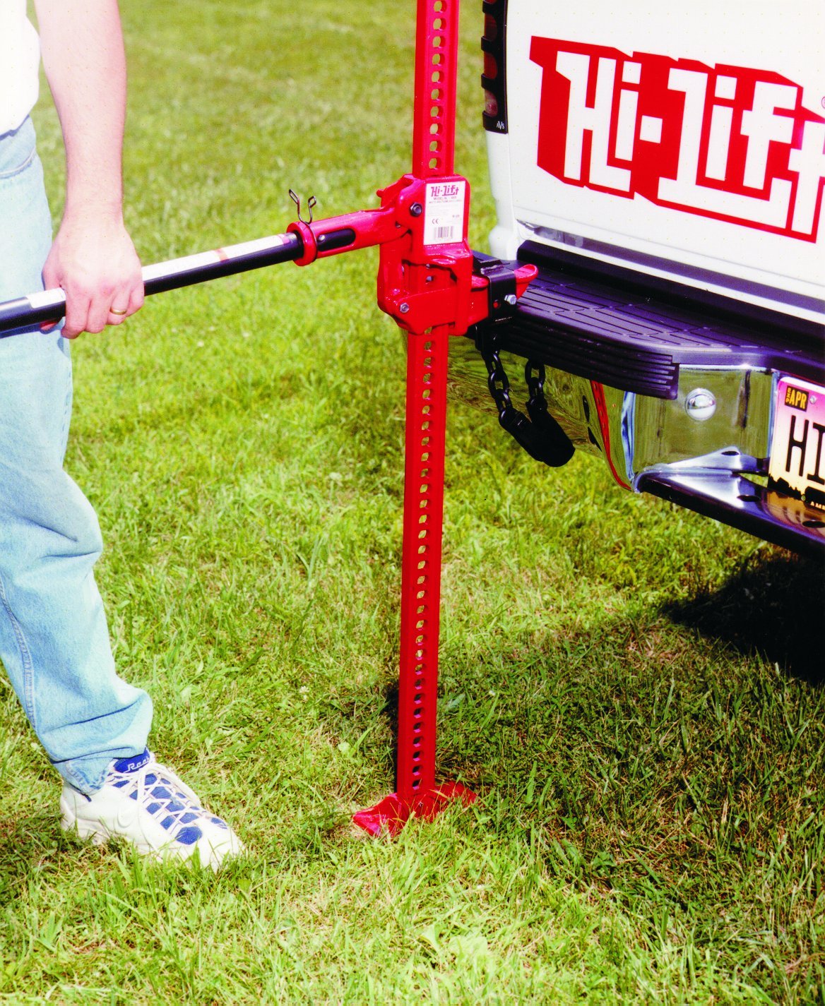

Not to high jack this thread, but has anyone used a hi-lift jack? My ex is lifted 6 inches and all I have is a hi-lift.
Hi-lift jacks are not stable enough for use as a primary jack.
Where exactly would you place the lifting thumb of the Hi-Lift jack on your EX? The only place I can think of using it would be inside the hitch opening and I agree that the Hi-Lifts are way too unstable to be used as primary maintenance jacks, pretty small baseplate footprint on those jacks. I would look to using a typical floor jack, 3.5+ ton on the diffs, even with your 6" lift and 37" tires the diffs are only 2.5" higher than stock. You may need taller jackstands to brace up your frame with that much lift though.

Good point. The last thing I want is all that weight shifting and the truck falling over. If I were to use the hi-lift, I would jack at the rear receiver and keep the tires on until it is supported by jack stands.

Amazon.com: Hi-Lift Jack BL-250 Bumper Lift: Automotive Amazon.com: Hi-Lift Jack BL-250 Bumper Lift: Automotive
However, as has been previously stated, terrible choice (safety wise) for use as a maintenance jack. If it's your only choice, make sure you always chock your tires and have jackstands at the ready to be immediately put under the axle.
