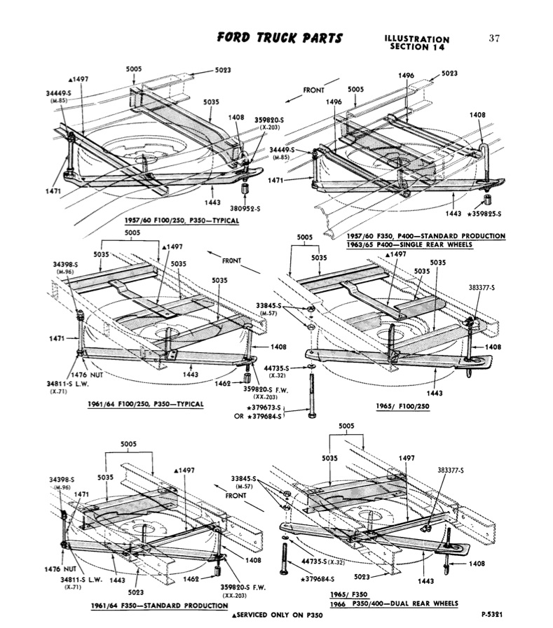

My '59 came without a spare tire or tire rack, so when I saw a rack for sale, I bought it. It came with two long bolts, one has a slight bend in one end.
My question is, how does this thing mount to the underside of the frame? Anyone have any photos? Any help would be greatly appreciated.

This may help!
Good luck in your quest!

This does help. Now I know where to look for the hole in the frame for the front bolt.

Very helpful! I can see where all the pieces fit. Thanks so much.
