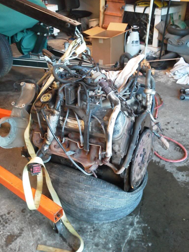

Just pulled it today. It was running fine. I am going to get it on the stand tomorrow and pull the oil pan and see what the bearing look like. I am kind of pissed I pulled it now. I thought the rear main was leaking but all it was is the stupid oil pressure sensor on the back of the intake leaking. Oh well
Im not sure which was worst, pulling the tcase and tranny or the motor lol
I don't know why my pics want post

I thought the tubes for the AIR system connected to back of the heads. I don't see them in that pic. It looks like they connect to the exhaust manifolds instead.
Whalebus2112, could you please take another pic from the same angle but on the other side of the motor?

Sorry I didn't read this before I tore it down but the air pump does tie into each manifold at the rear. I am removing mine and welding the holes shut.

My first rebuild I did not over bore and went with stock rings. Following this I was adding a quart every 200-300 miles. If you take the pistons out make darn sure your cylinders are within the bore tolerance and are not out of round. Otherwise bore it out and do it right. I would not recommend welding the holes in the manifolds. I removed my air pump and used stainless steel plugs on my headers.
