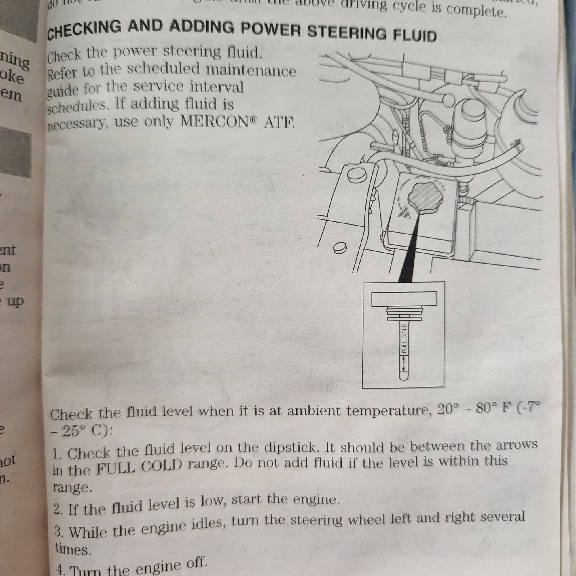

Then hour + of confusion with several calls with Ford and Auto parts stores, over Transmission fluid versus Power Steering Fluid called Mercon ATF and why "they" were conflating the two, when I'm just looking for Power Steering fluid called Mercon ATF!
Advantage Ford Parts clerk Robert, explained factory OEM PS fluid is now Mercon V. Now after 5 PM they were closing too soon for me to get there. I gave my credit card number purchased by phone and Robert left it for me on the Sales desk.... I got it ! riding back roads on my moto, around L.A. rush hour traffic.
I added a pint of Mercon V to the Power Steering reservoir, of course I over filled it since it kept sucking up more and reading how much Russ' needed. So when starting up and pressing the brakes it flexed outward on the thin little square plastic reservoir, which then spilled out the excess through the cap. Wiped that up over and over, pulling more out with a straw, till it stopped flexing under engine running brake presses. And yes in 10 minutes it was starting to feel normal again, after several right to left turns and braking tests around the parking lot and streets. We were back on the road to our State Park destination and we made it there by midnight.
You can judge, but realize I am a diy mechanic of 50 years, servicing most needs of my bicycles, my motorcycles, my cars, fixed every home appliance, added plumbing, electrical, remodeling, to above code levels (thanks dad for the training). I thought I was doing a good job of keeping up service, fluids and rad flushes and oil changes too.
The important part in your maintenance is to understand that even though you are checking the Transmission or PS fluid regularly, realize that the dip stick process for both is somewhat tricky. Somewhat unreliable. "Warm" (level is lower on the stick) versus the cold measurement. it should have fluid to the top of the PS dipstick in the "COLD" state. And how even if the engine is warm, your PS ATF fluid could still be cold-ish. And then there is a >50F factor to be aware of on ATF or PS fluid checks.
Do not be fooled as I was, by this PS reservoir's short 2.5" dip stick controlling so much of your rig's mechanicals.
If you have the Transmission fluid service you have to carefully read that section and how to drive it 20 miles, etc. to get good readings.
You can't rely on Dealers or Quick Oil Changers to do this to the quality level required, nor to understand and comply with your Econoline 450 system nuances.
I will be checking this much more closely in the future realizing how much of my driving is relying on this small quirky reservoir.
