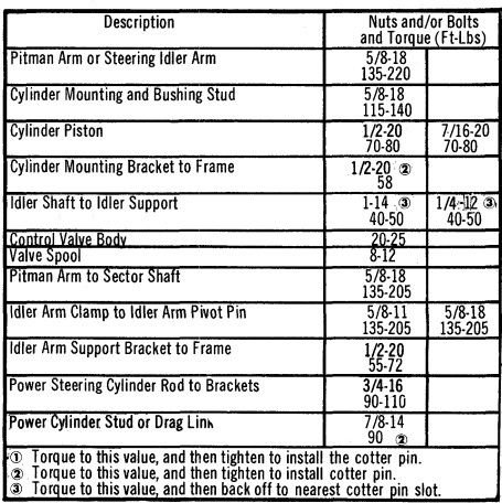

I know this is an ancient thread, but it came up in my search for the same info, so here's the answer from the manual, should anyone else find themselves in the same predicament.
