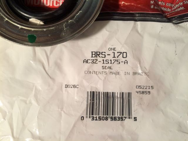

does anyone know what the part number is for the replacement dust seal (the new metal one, not the original neoprene one) for a 2004 f-350? I believe I have the dana 60. Will it work in my truck and axle?
Old May 10, 2017 | 04:50 PM
hodge5's Avatar
hodge5
Joined: Aug 2014
Posts: 546
Likes: 30
From: VA- Shenandoah Valley
You do have the Dana 60. The part # is 3C3Z-3254-CA. I just replaced mine today, while doing ball joints.

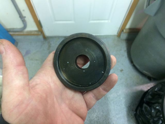

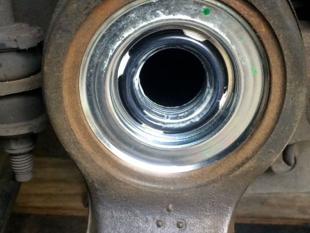

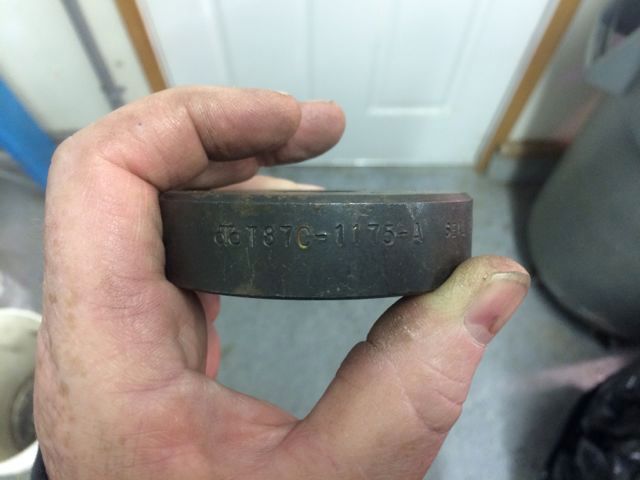

I'll go look and see what tool I used.
This was for my 2006 F350
Now for the tool. T87C-1175-A
FORD ROTUNDA TOOL OTC T87C-1175-A HUB SEAL REPLACER | eBay
EDIT you might want to search Ebay by part number I just found one more for less.
The other option and it does work is find a PVC coupler that fits the seal inside the raised
lip and just work around the PVC edged with a tap hammer.
Ford OTC Rotunda T87C-1175-A Hub Seal Replacer Tool F-250 F-350 F-150 Mustang | eBay
Here is that tool on Ebay. Way over priced from what I paid even.

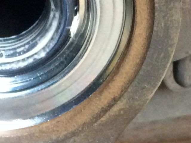

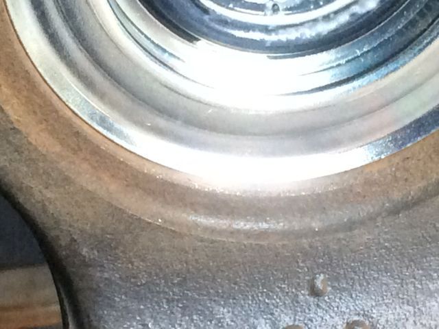

The seal has a lip that the seal drive does not touch so that when you
push it down in the bore the up turned edge holds it in place. You
can see how it should be seated in the photos.
Be sure to clean all the rust from the axel shaft and apply grease so
that you don't rip the seal as you push the axle in. Also you no longer
need the old support that is in the tube if it is still there still.
One thing I did before sealing things up was vacuum out the axle housing
on both sides just to remove any dirt and flakes from the tube.
