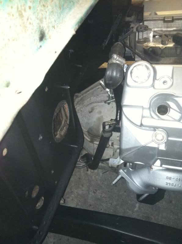

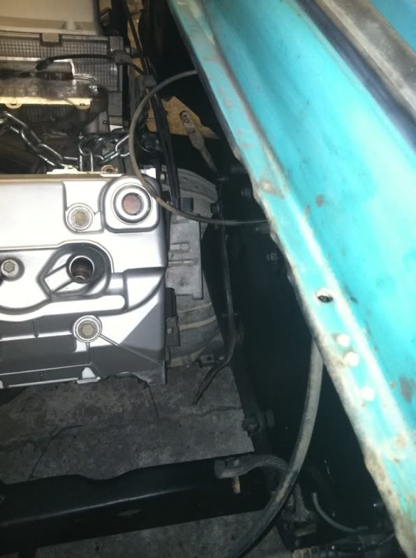

Can you post some photos of firewall to engine clearance?
From the looks of the intake you are using a 97/98 engine?
Ron Francis is the only one I've found that makes a stand alone harness for the 4.6 32V AND can reflash the ECM to delete the PATS and misc. emission codes.
drivers side, the IMRC controller is 1/2 inch from the firewall
passenger side

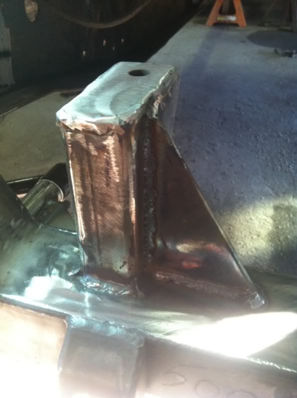

mount
I built my mounts on the mustang II crossmember crown vic style and used crown vic motor mounts. I also moved my axle centerline forward 1 inch. If you bolt it direct to the crown vic crossmember to me the motor sits low in the engine bay so I raised my motor and trans till the trans was just clearing the trans tunnel and built my motor mounts there. mine is a 97 motor but using a 98 cobra intake. I am using the complete Mark VIII harness, getting the most out of my donor car. I will be using the ignition switch, instrument cluster, shifter, radiator, condenser and fans with all the factory wiring and controls. should be fun
