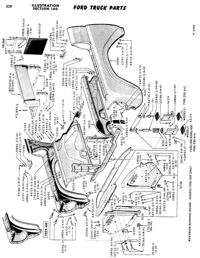

I can't fi9gure how the inner fender wells are supposed to fit. They were included in the basket case I bought. But I can't figure out how they mount.
Any advice or pics would help a whole bunch. Thanks

Here is what the parts catalog shows!
Name:  front fender.jpg
For the inner fender IIRC there should be three bolts to the radiator support another 4 to the outer fender and a soft attachment to the cab.

Thanks. That's all the help I needed. Sure harder putting together a truck that I didn't take apart. I did take it back apart so alternator mounting/bracket fab will be easier.

If you don't have one yet, I (maybe I should say "we") suggest that you purchase a copy of the parts manual, from which the diagram Teddy posted came. It is FULL of info just like that, for the WHOLE truck. You won't be sorry. Best dollars you can spend.
