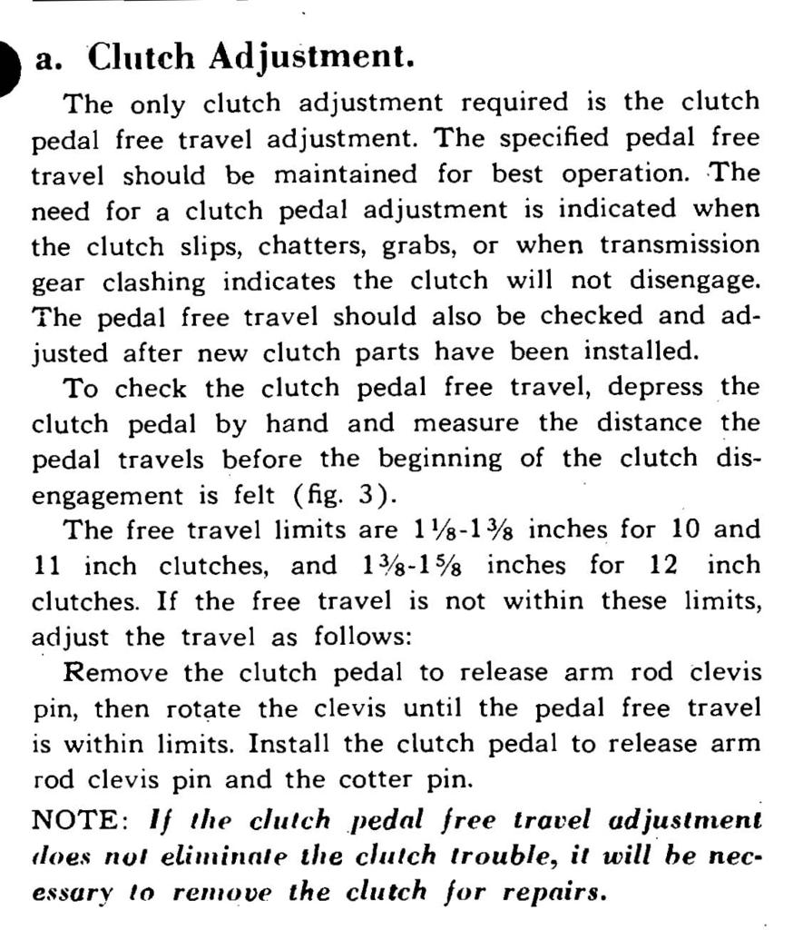

I have double clutching down for 2nd, 3rd, and 4th. However, sometimes (maybe more often than not) , when I come to a complete stop, I can't get into first without several tries. Am I doing something wrong here, or do I have a problem with the tranny?

Same with 2nd from a ded stop, can't get it into gear without grinding most of the time. What might be wrong?
Could be something simple like the idle set too high. If idle is normal, maybe the clutch needs some attention. Could just be out of adjustment...

Thank you. I'll check these ideas when my truck comes out of the paint shop. Thanks again...
