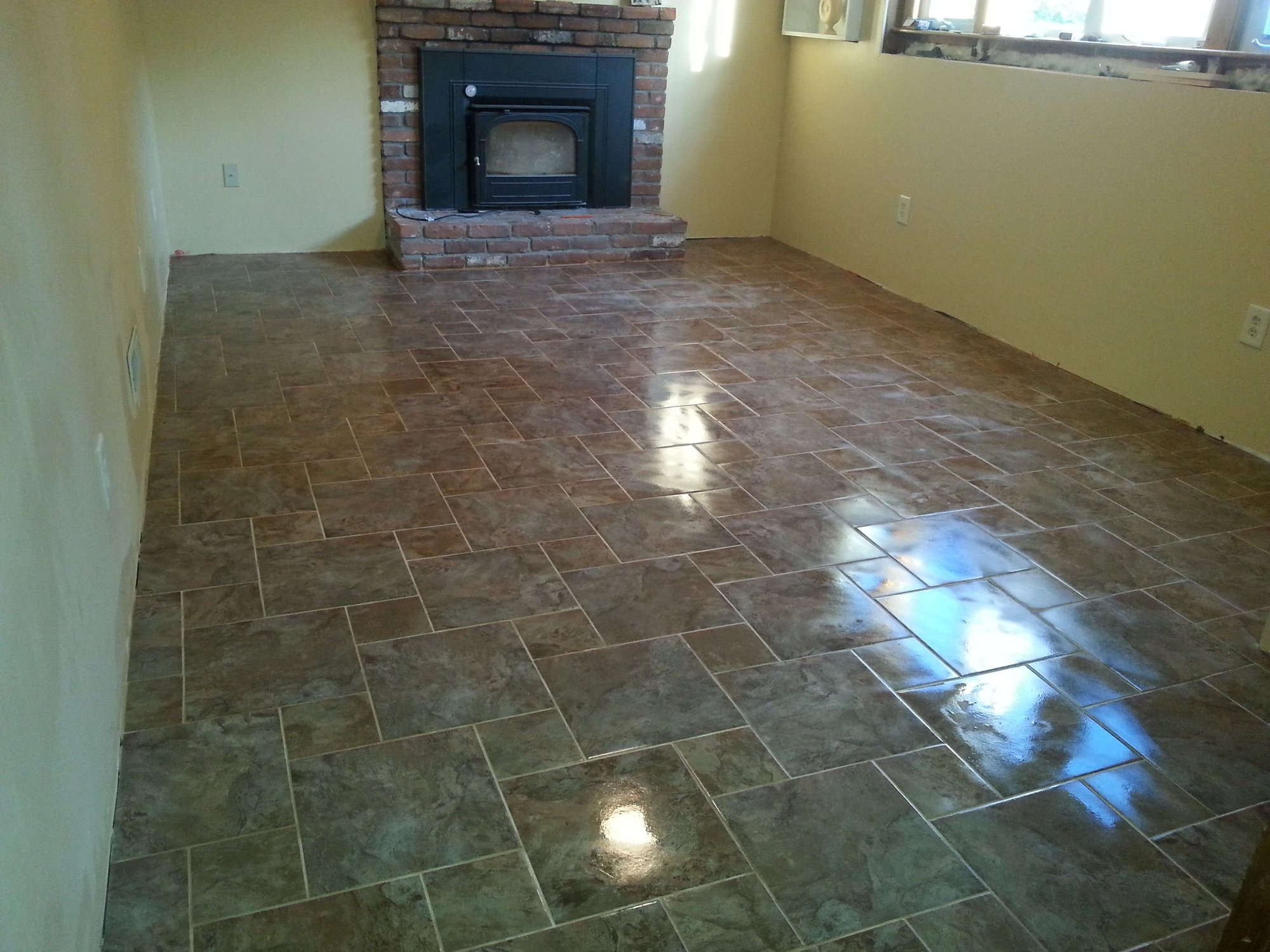

I hate loose ends so wanted to update everyone on the progress of this little project. Over the winter I finished the walls and got it all painted.
I found a tile guy through a friend and he gave me a great price to lay the tile. He recommended I sand the floor with a flooring edger and 36 grit paper and then put Redguard on it. I did as he instructed (both simple jobs) and he put the tile down yesterday. It came out very nice in my opinion.
Thanks again for all of the advice and assistance. Guys on here make a project so much easier.

Looks good Ray, you will be happy with tile, specially with a fire place no burns on stupid carpet or Laminate.

That looks amazing Ray.

I forgot to mention that the guy I hired to lay the tile told me he had never seen a homeowner prep a job so well. He was amazed that within 10 minutes of arriving at my house he was mudding tile.
If he only knew the work that went into that prep... :-)
