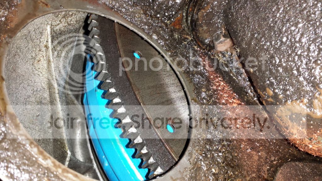

What is the condition of your flywheel ring gear. You need to inspect it closely as your next diagnostic step.
Old Oct 28, 2013 | 12:17 PM
wotan's Avatar
wotan
Joined: Aug 2011
Posts: 282
Last time I replaced the starter I pulled the engine around via the belts a few times and as far as I could tell -- it all looked like this.
