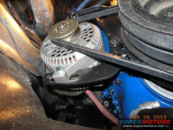

I just did the 130 amp 3g alternator upgrade with the low mount ford bracket and it fits as long as you use the right belt. It clears the trans cooler lines too.
