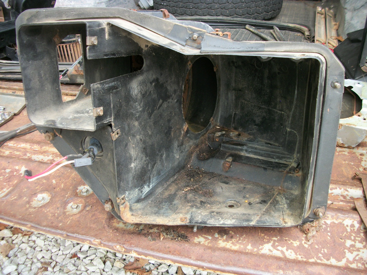

I had no problem taking the evaporator and heater core out today.
Why did you have to cut it apart? Oh was the box still installed?
Yea I know having it on a tailgate made it a ton easier....
Nice pictures. That sure makes it easier to see what's what and how it all
fits together.

Yea I should of made a how to dissemble thread...

Wow! Thanks everyone for the info. And the pics were great since I got to see what the AC evaporator looks like. I can well see how removing the cores are much easier with everything taken out from under the dash - definitely not the method I took!

Then again I removed it from a bronco with the front clip and motor removed, not a fun task with all that still on the truck.
Any questions about taking it apart, just ask.
