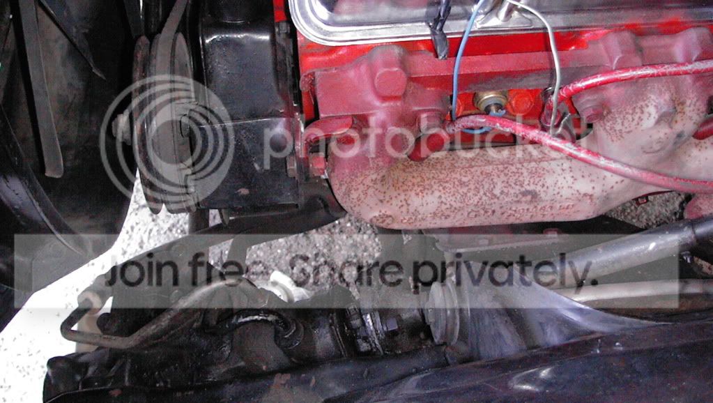

Long pumps are easier to find, but try to get everything from the same car/truck so you know it will work together and be basically a bolt on. I would look for pictures of early 70's cars...Camaro, Nova, Chevelle, the trucks had some different brackets, also make sure it's for a small block. I have a few brackets here from early 70's Camaros but not the main pump holder bracket. If you really want to they repo all the brackets for Camaros and then just get the pump for that application......but I'm cheap and don't like repo parts .
Something like this:
Or this, but you'll need to fab up something for the header mount...pretty easy:

By the oooks of the pic, that pump ant mounted right, , is it supost to be level? jegs has got one, , i will have to one and just get a pump, ,

Seldom does the pump end up with the fill cap pointed perfectly vertical. The rez is large enough to be angled without issues.

They're never 100% level, but like AX said the volume is enough inside the reservoir.
