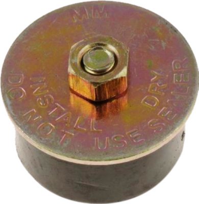

There are expanding rubber plugs in the market but they aren't intended as a permanent fix... only to get you by until a proper repair.
$14 from Jeg's. Use brass, not steel.

Like it was said above , the rubber plugs are not to be permanent . I have had them to pop out in three different engines, the first two i caught in time the last one i never. It was in the 73 i bought about a year ago and came out about 1/2 of an hour after i paid for the truck . The guy i bought it from was following me home with it and it came out . By the time he knew it the engine was gone, that's one of the reasons i have a 302 in it now instead of the 360 . He did offer to return my money but i turned him down , it was not his fault , crap happens.

I had the same plug leaking on my '78. Was easy enough to get it out but there is not enough room to get the new one seated properly. I ended up installing one of the rubber ones. It's been in for about two months with no problems. I know it's not a permanent fix or ideal but it's getting me by for now.
