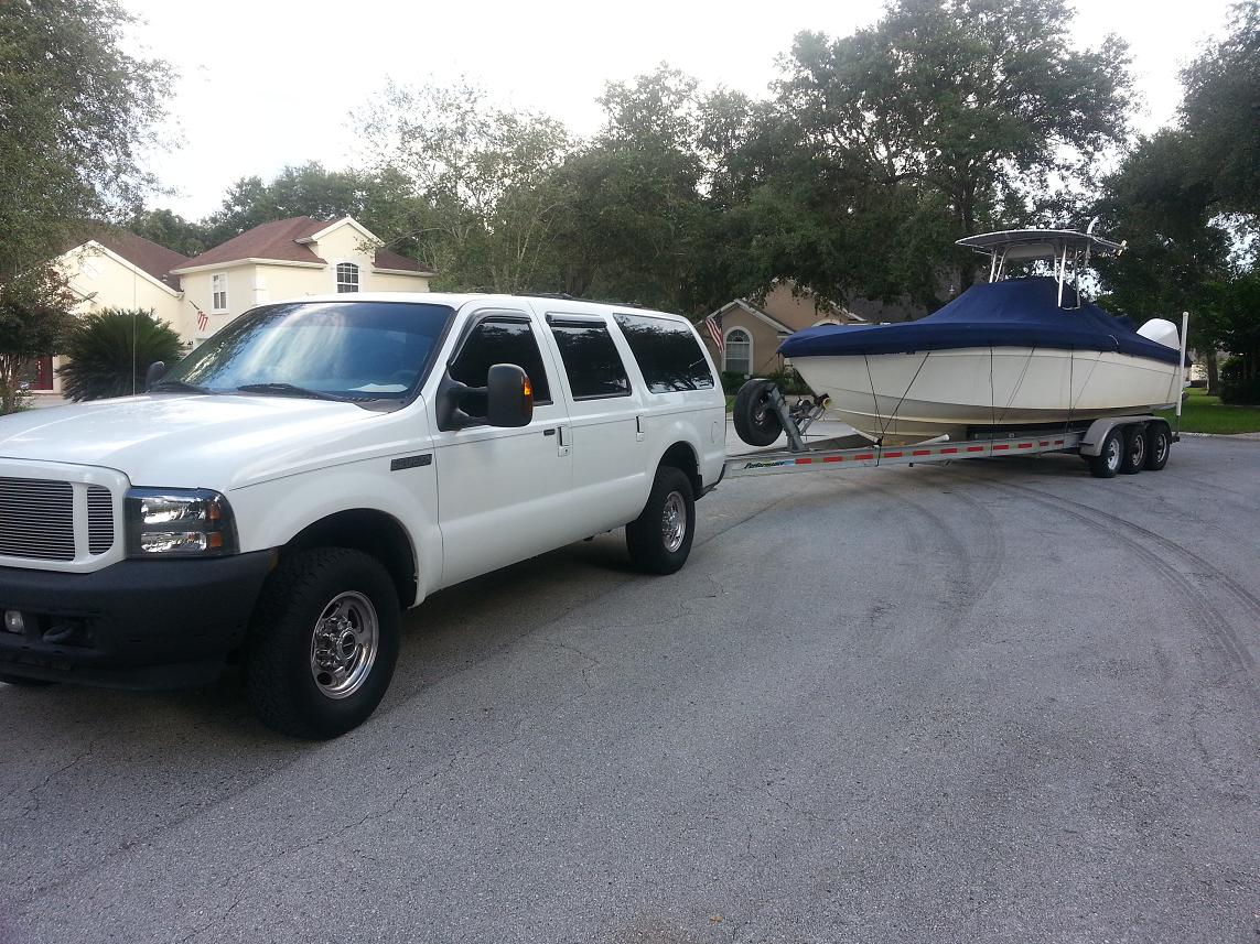

What boat are you towing? Any pics?

id read the +15degree thing before...it only ever got about 10deg hotter while towing...coming to a stop...or driving unloaded...the eot and ect always remained exactly the same...this led me to believe that the oil cooler was working just fine and the added strain of towing just made the oil that much more hot.
definitely something to always watch for sure...I love the torque feature that allows you to set a warning temp so the gauge will blink.
I tow a 32' floating beer cooler w/ twin evinrude 250s. managed to snap a shot before I hauled it back to the farm for storage.
