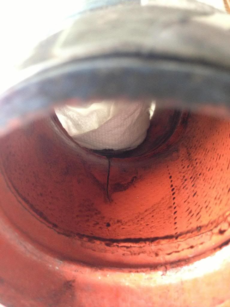

I was towing my horses up a steep grade and started hearing a screeching sound coming from the area around the turbo and I couldn't get any more power out of her to push up the mountain. I pulled over but could t find anything wrong until I got home and took the intercooler boot off and found this:
I'm thinking of using the riff raff boots to replace because they are cheaper than the dieselsite boots. Have y'all had any experience with these?

I've been running the Riffraff boots for a little while without any issues. I tow heavy through the mountains of NV/UT. Haven't read anything horrible about them, and they look good too.

My turbo boot looked like that, it would whistle some at high boost, otherwise I wouldn't have known any better.

It felt like I hit a wall going up the mountain.

Do the RiffRaff boots have the bead inside? I read somewhere that they were smooth inside on both ends. That's why I went with the BD Diesel.

I can't remember if Riffraff told me or I read it somewhere. The oem boots are 3 ply. The Riffraff are 4 ply.

Whatever you choose apply aerosol hairspray before putting the boots on, it will help and of course clean really good with carb cleaner or brake cleaner.
Even better would be to do the CCV mod and keep the oil out of the boots.
