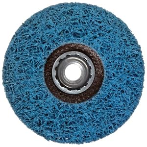

I welded patches in the rockers and rear wheel wells and wanted a good, clean surface to apply epoxy primer and body filler. I blasted the area that I felt could take the blasting but the flatter, more open areas like the roof I didn't want to take a chance and warp them by blasting them. The roof had old paint and surface rust. I started using a fiber disc on the old paint and surface rust.
This disc got all of the gummy, old paint off and seems to be lasting a long time. Saved on a lot of sand paper. It also seemed to not dig into the metal too badly, it did make sparks but I tried to not to make sparks as much as possible. After I had all of the paint removed I went over the area with 180 grit paper on my DA sander.
