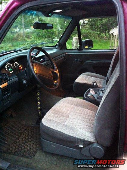

I am running 89' Bronco bucket seats in my truck. The bracket for them had the right shape to bolt to the floor in my truck, but there were no holes for them. I simply out them where they seemed right, drilled 4 holes per seat and used all new grade 8 hardware to bolt them in. I use large washers to help prevent the bolts from ripping through the floor. Been a couple of months and a ~1000 miles and no issues. I absolutely LOVE the 89' buckets. They have loads of support and are really comfortable.

These are what I have and I LOVE them.
Those bricknose Bronco seats look pretty good.
