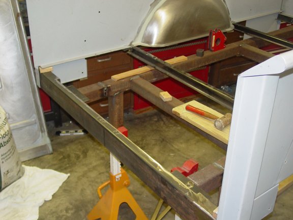

and u didn't weld the cutout piece back into the hole? you ever get any water up in there and you'll have rust dripping out the ends of the bedsides!..

I don't understand your last post completely... I can see where I'd get water in there... but the orig was completely open on the bottom... I hope to get a good coat of primer/paint in there and I could always cut in drain holes too ??? wouldn't that work ??

Originally Posted by jniolon
I host them on my site and here's the text to display them
I started cutting out notches with a hole saw... and didn't like that... then tried using Metabo with cut off wheel and making square notches... didn't like that... gawd I'm picky... then I cut the whole corner of the tube out with my plasma cutter, dressed it slightly and added the mounting angles on the inside (bedside of truck)
then I slid it into place for fit (sorry, some of the pictures are a little busy, but I wasn't gonna move all that crap... zoom in !
open on the bottom will dry.. open on the top is a trap..
drain holes.. well maybe..

Looks like it will work to me. It would be a good idea to make sure it had drain holes in it. In reality, with a good coat of sealer in there it will last longer than you will....LOL

Maybe a nice coat of industrial epoxy finish on the inside... that stuff is indestructable. thanks Bobby for thinking I might live that long !!!!!
revision 1...
two nice thick coats of Sherwin-Williams commercial/industrial Macropoxy...with adequate drying time between coats... fully coated...
rust ??? we don't need no stinkin rusty.. eh Sam ???

might work!.. looks good..
