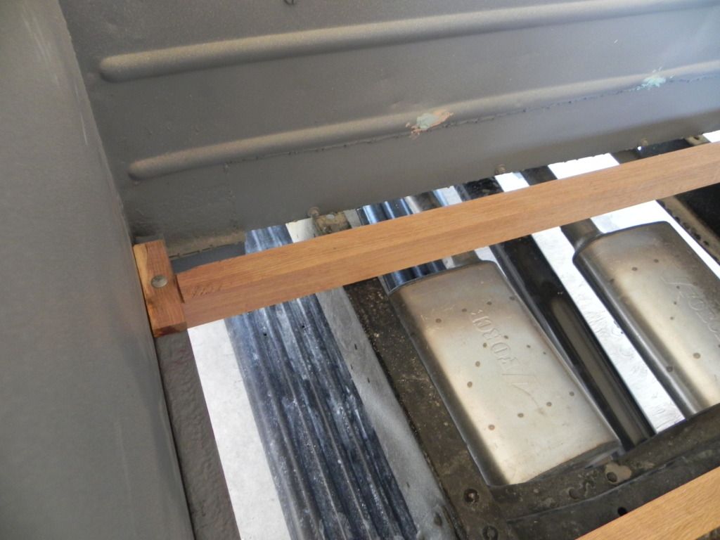

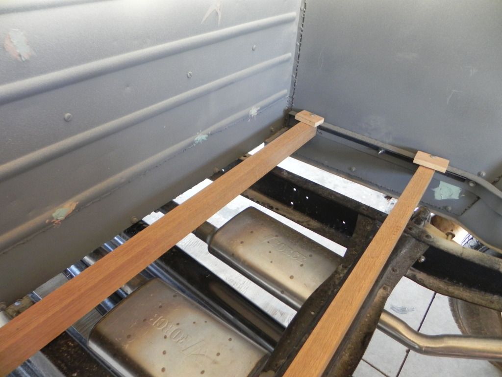

alright guys, I got the bed set onto the frame tonight. Problem is that it's sitting on the front edge sheet metal and not on the crossmembers.
I didn't do a very good job documenting pulling the bed apart originally. I have three of the original crossmembers and all are 2 1/2" tall. The only metal piece going across was the rear crossmember. Is there a piece on the front edge I'm missing? Maybe I have the angle iron brackets on the bedsides upside down?

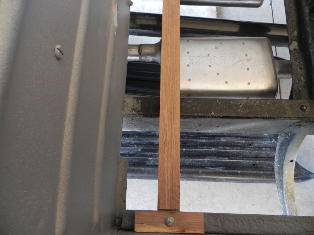

It's a 52 express bed. I figured out part of the problem. When I rebuilt the rear crossmember I didn't account for the flat bottom of the original. Probably because there wasn't much left of it. The 1/2T replacement I spliced into it ended up being almost an inch and half deeper. That rested on the framerails and made the back of the bed sit up too high. I had to make some cuts in the bottom and used a very manly c-clamp to make the bottom flat again. Would've been easier to cut out and reweld when I made it if I had paid more attention to it.
On the front, I ended up using some 1X flat oak spacers (about 3/4" tall) to raise it up to where the running board holes lined up. It's going to work out, I just don't remember there being anything under the wooden crossbmembers to raise them up and can't figure out why the bed would sit on the frame now.
