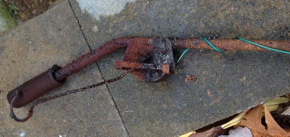

Just replaced my tank on my 78 not too long ago. I think the rule is that if you have a skid plate then that means you have a 33 gal tank No skid plate = 25 gal. I ordered my new tank from LMC including a new fuel pump, sending unit and gas lines. My tanks was real nasty -sounds like yous is too. Good Luck...
Look at this crud...
