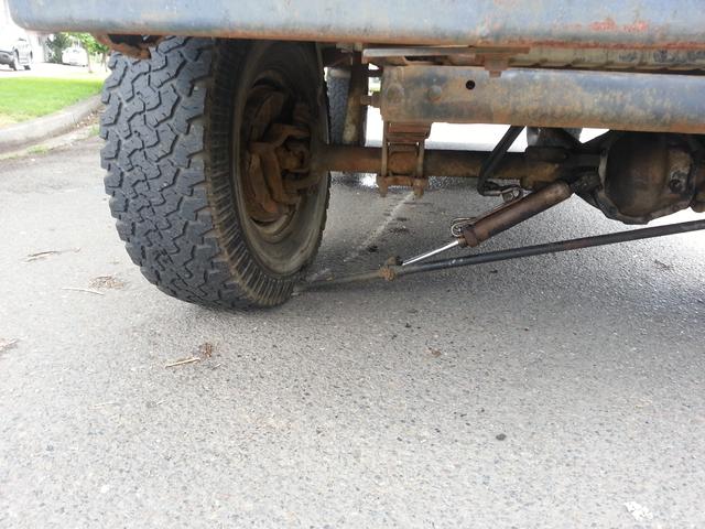

Attachment 293054
Looks like the castle nut backed off the drag link. The cotter pin was sheared completely off. From the looks of it, whoever owned the truck before me, didn't proper care of it.

That doesn't look to be a failure of the power assist system, it looks to be a simple failure of the tie-rod.
Do you want to just replace it and drive on? or do you still want to dump the whole system?

The rod for the ram is actually bent. I thought about trying to straighten it out, but I don't know how well that will work. So i was thinking of dumping the whole "ram assist" thing
That's no bueno, those things are 250 bucks too (reman'd).
