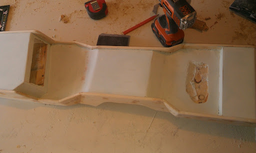

Got home from work this afternoon and thought I'd try my hand at this icing stuff. I mean, what's the worst that could happen, right? I could just destroy all this hard work!! ok, maybe that's a little extreme!!
This is the "icing"...
Here is about a 4" puddle. As bikerman pointed it, it does self-level. This comes in handy - and not handy sometimes!!

I decided to break the edges on the sides. This way regardless if I carpet or paint (and ice) it should make things a little easier.
This was just a sanding block and some 80 grit and a lot of elbow grease!!

After taping off some holes so this stuff wouldn't run down through them, it was go time...
Not having any experience with bodywork, this could definitely have gone smoother. I must have completely missed the part on the instructions when it states "only mix as much as you can work in 3 minutes"
This stuff pours and self-levels very nicely but it sure sets up quick!! I worked with some sections too long for sure!! It's like working with drywall mud after it starts to set-up. It is actually detrimental to the final finish when worked too long!!
That train wreck of a recessed area is me attempting to "freehand" a pocket using my router!! This is to clear the parts on the factory interior light. Note how the icing free-flowed right down into that pocket!!

Since I had most of the surface jacked-up, I had to start sanding. Fortunately this stuff sands pretty well! There are some areas on this console that are difficult to sand.
After sanding...a LOT...there are just a few small areas that are still need sanded smooth but there are other areas that are pitted up. So tomorrow (and I have a VERY busy day so hope to fit it in) I will mix up some more icing and coat the "low" areas.
That should set me up to sand it all down, right down to 320 grit and then I can start coating in primer and paint!!

Oh, one thing I need to consider is that once I lay down the paint, I will then need to spray glue on for the carpet. I will need to mask/tape off the painted area while I spray the glue so if anyone has any tape they would recommend (blue tape, whatever) let me know!!
The area to the right where the icing is missing is where I still need to cut out for the switches. I don't have the switch mount or I would have cut this out already.

As planned, I was able to sand the first coating of icing.
I then added a 2nd coat which went MUCH better!!! I worked in smaller sections so it didn't set before I got it the way I wanted!! Was able to get a smoother finish. I was able to use 320 grit - dry sanded - and the finish was awesome!!
I sprayed it up with primer and with a uniform color it looks GREAT!!! I can see a few areas of cavitation. I can hit those with icing in the morning, sand and primer again!!
I plan to paint this blue to match the truck, but , TBH, I LIKE the color of this gray primer!! A lot!!!
