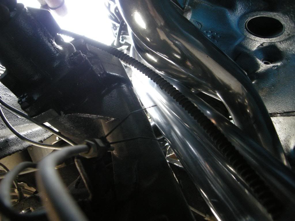

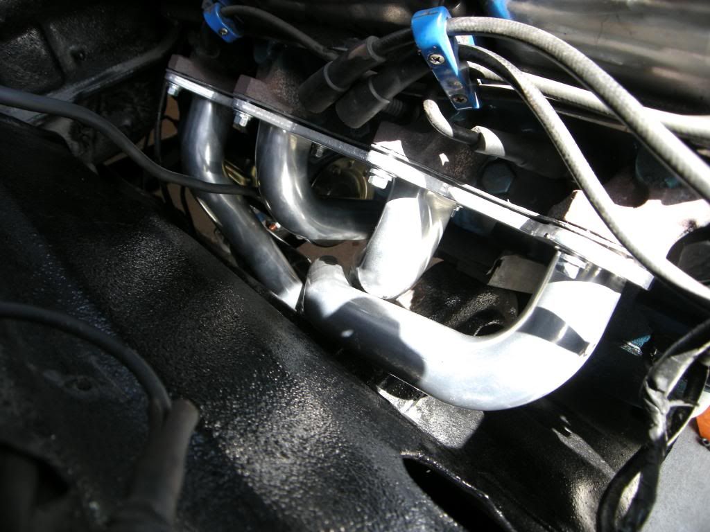

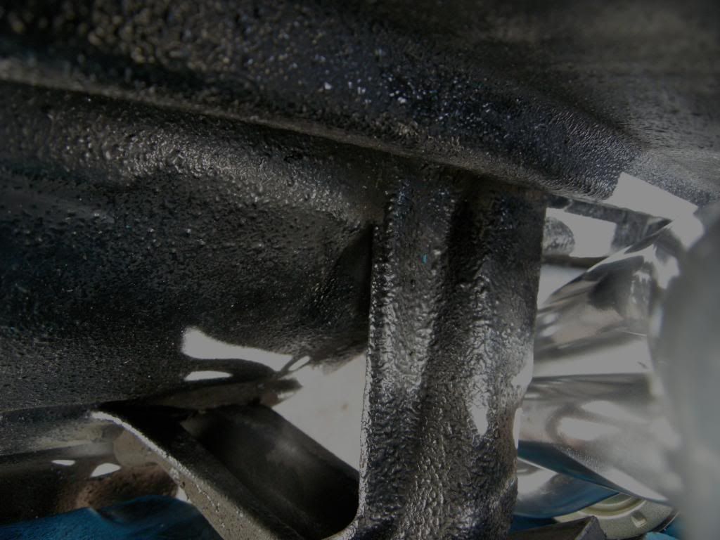

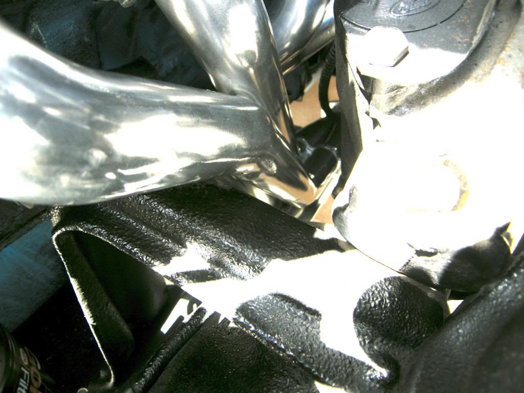

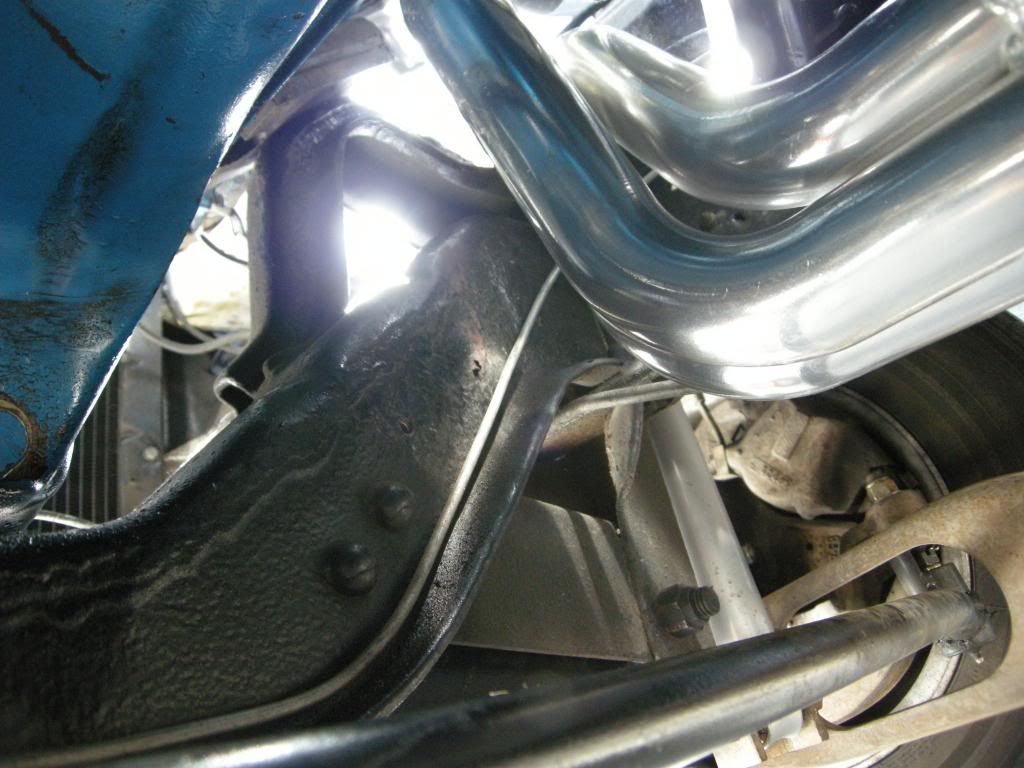

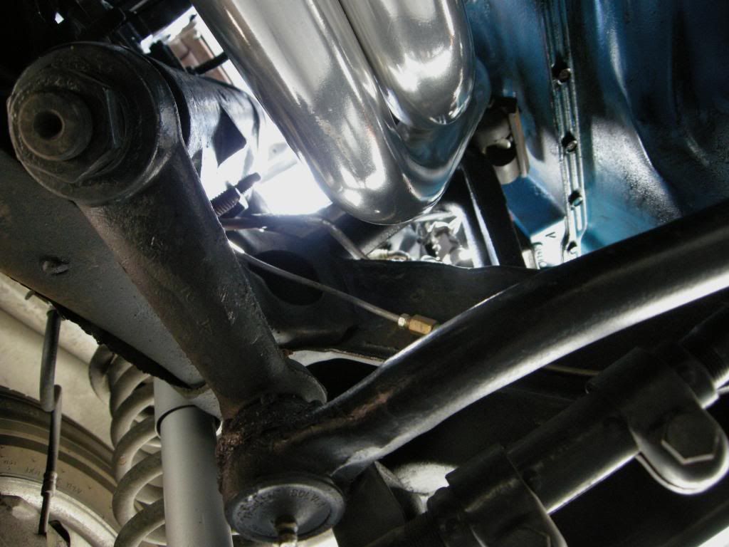

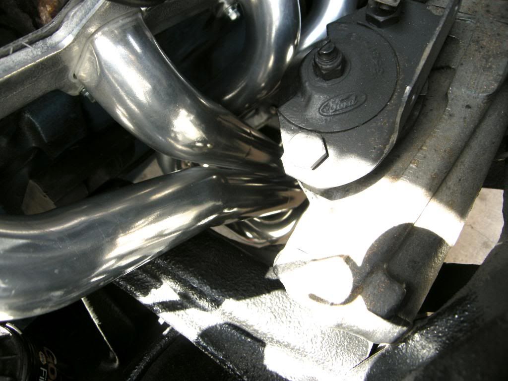

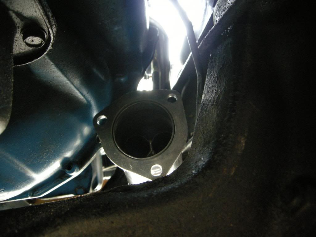

pictures as promised, the headers are completed but still have heater hoses and little button up stuff to do. hope this helps!!

Tons of room, did you start it up to let the neighbors hear it roar?
