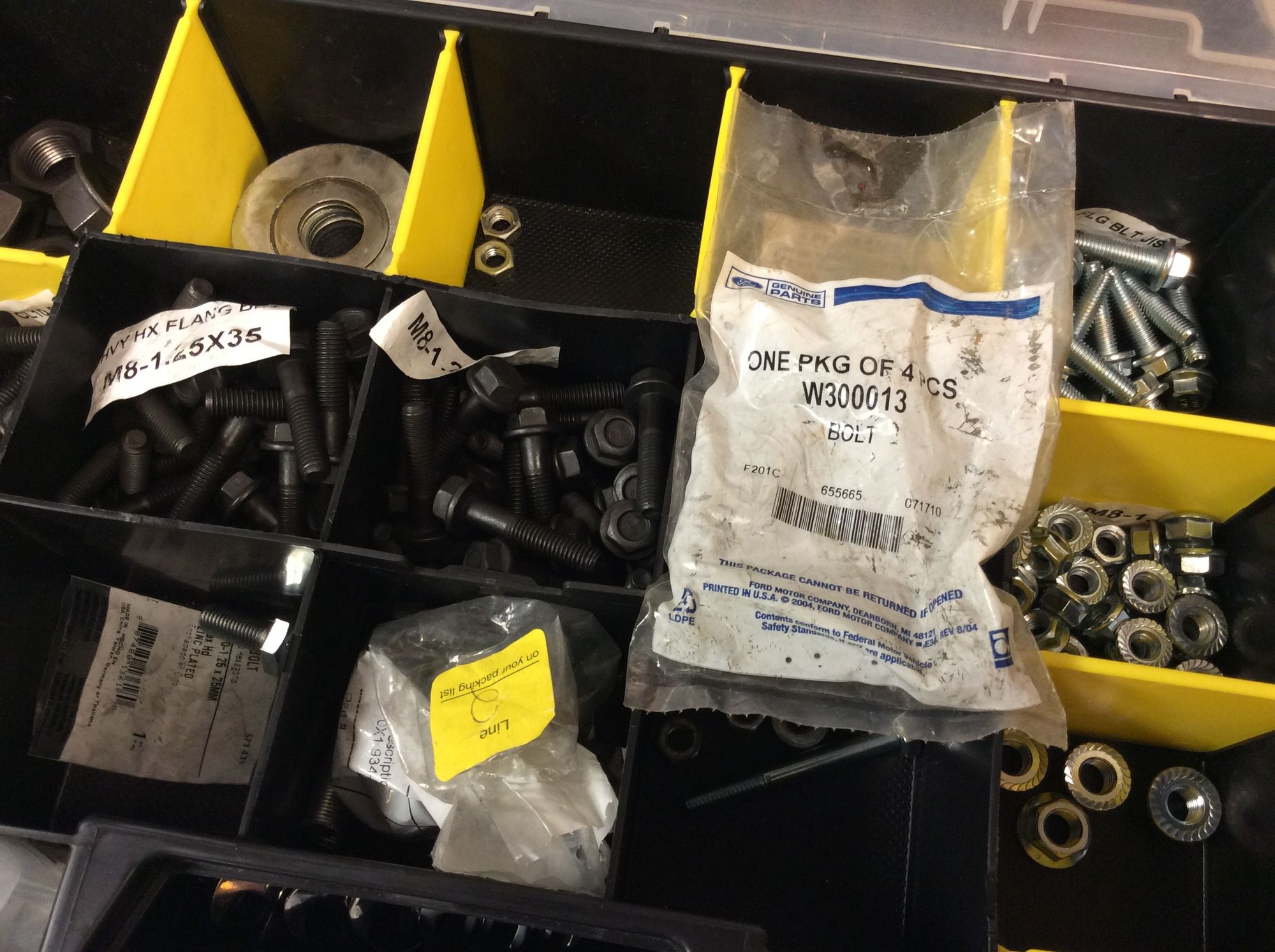

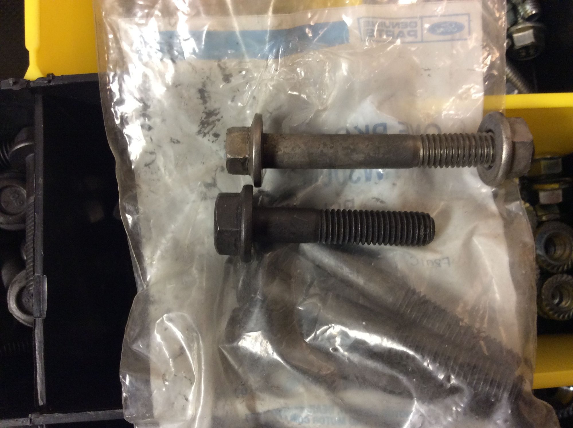

They are just flanged metric bolts of 10.9 strength ...... and the same quality flanged nuts, with black phosphate coating.
The nuts are about $10 to $11 per 100.
What is unique is they have a smaller hex (10mm) then Metric Class (13mm) or JIS (12mm). In some cases the drive socket will interfere where the larger hex fits, although the larger hex is less prone to stripping out.
