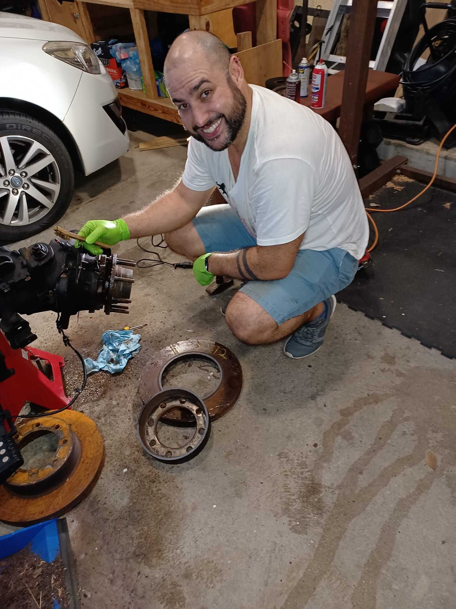

Suffering through this right now…I don’t know what else to do, I even broke a rotor trying to get some leverage on the hub…

I am trying to remove the hub bearing. I’ve removed the 4 nuts from the back and the snap ring holding the axle shaft, but the hub bearing won’t come out…heat, penetrant, hammering, nothing is helping!
A 3-Jaw puller against the axle shaft you mean?
