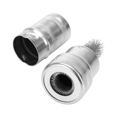

Don't just "check" the battery connections. CLEAN THEM! You should use a tool like this to get down to good, somewhat shiny lead:
.. then clean the terminal ends on the starter and the grounded end bolted to the engine. Plus cables can sometimes corrode within the sleeve where it cannot be seen.
