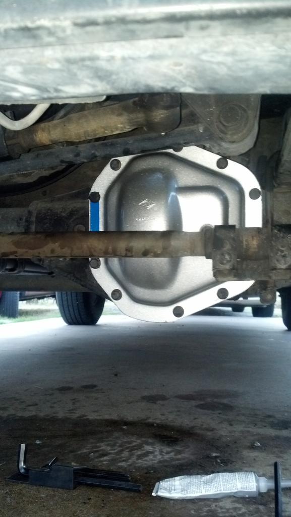

Dust seals for sure, the re-use of the knuckle seals will depend on whether you can get them out undamaged or not. Only hope of doing that is with a pry bar against the u-joint. Are you wanting to do a complete rebuild, or just replace those inner seals? Hopefully they don't leak anymore, and you don't have to do anything but change the fluid and take a peek inside at the ring and pinion. Pull the fill plug and see if anything comes out. If it does, you might have water in there that raised the fluid level. Also, good idea to check the vent tubes like you mentioned above.
I cleaned the rust off my cover and painted it up before I put it back on for corrosion prevention.
