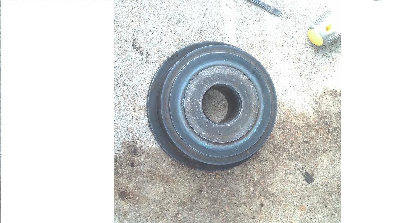

This is the seal driver used at the dealership.

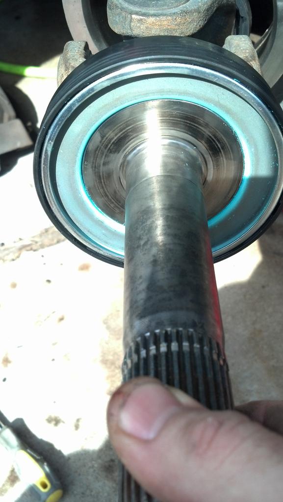

Here is the seal seated on the axle. You can see there is a slight step up from the flange of the axle to the flat area of the seal. That is where your plastic washer with the grooves in it will sit. This step must be exact, or your washer won't be able to do it's job....this equals no 4x4 ESOF action. I put the axle in a big vise to hold it while I drive the seal on. T

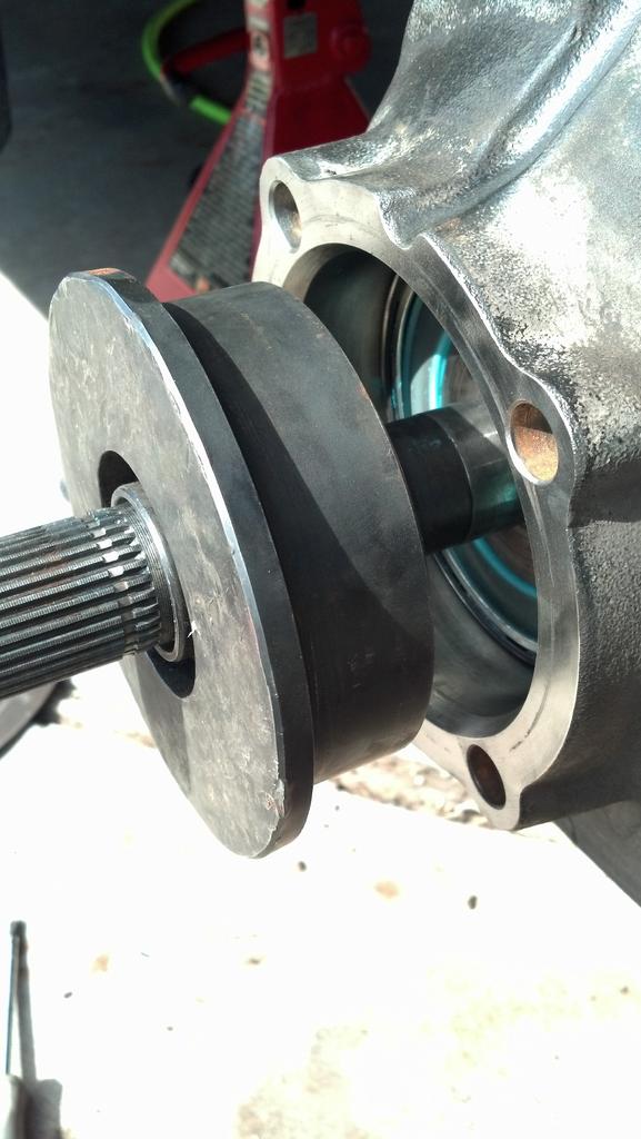

Here is the seal driver on the shaft. There is a special tool that fits over the axle behind the seal driver (I forgot to take a picture of it), and that gets hit with a big hammer. This exerts EVEN pressure to the seal and pops it right into the knuckle. A little bit of bearing grease on the outside of that seal before inserting it into the knuckle makes this go REALLY quick.

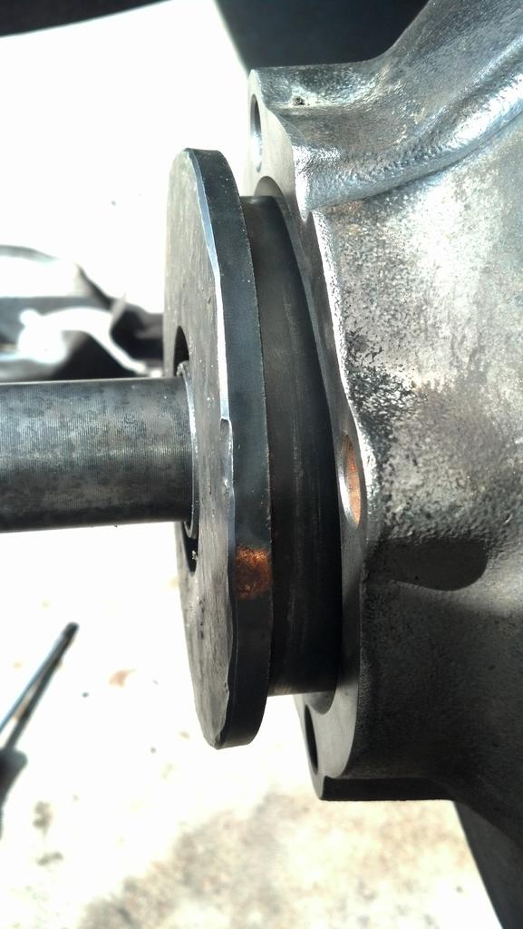

Starting position.
Attachment 68867
Driven to EXACTLY the right depth when the tool bottoms out.

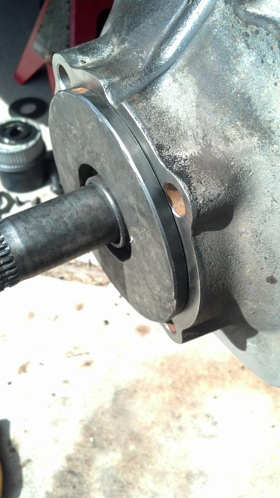

The result is a inner dust seal that sits snug up against the axle tube and is able to do it's job correctly without wearing out prematurely.

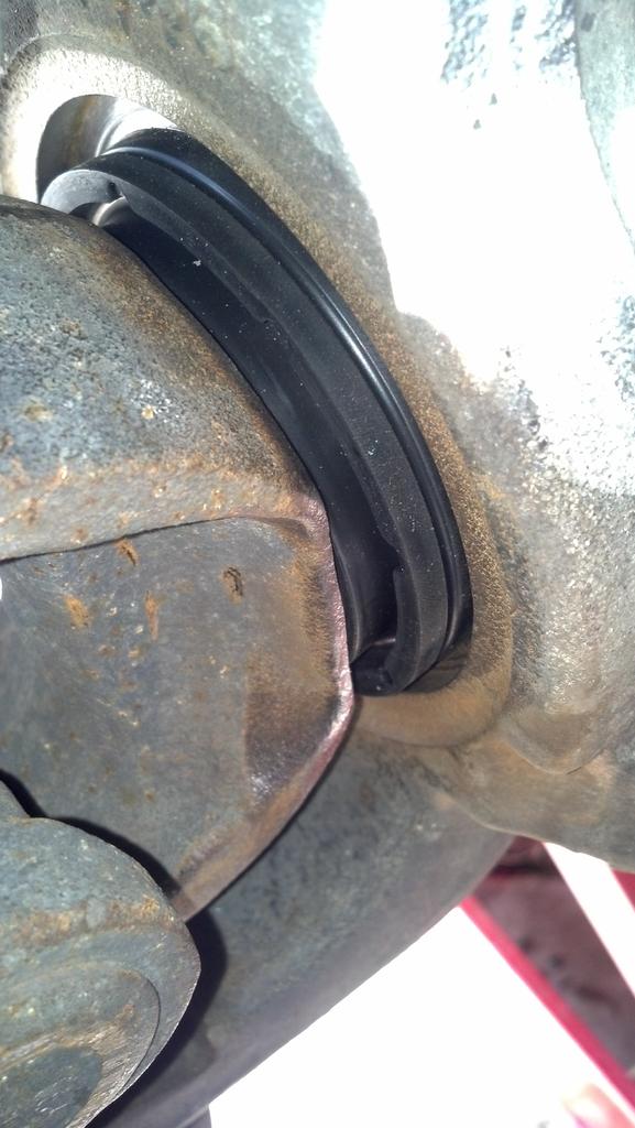

WOW those axles are totally jiggling around in there. I did this job YEARS ago and Im accessing old memories to try and recall if there is a bearing in there needing replacement....accessing accessing....

With the hub off, that all looks normal to me. The only thing holding the axle centered in the knuckle is the vacuum seal, and that is not designed as a structural component...it just seals against vacuum leaks. I would inspect it well...check around the edges and see if it has been damaged by whoever was wiggling the axle around in there in the photo.
Now, if you had wobbly movement of the axle while the hub was still on, I would look at the hub/unit bearing as suspect. The seal that is dangling is your inner axle dust seal. They are known to not last long...bad design on those. Not a critical part, but something to put on the list.
