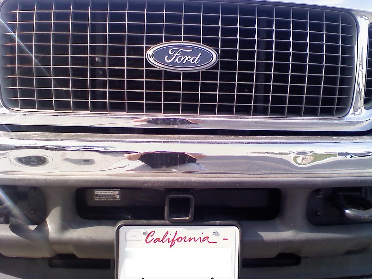

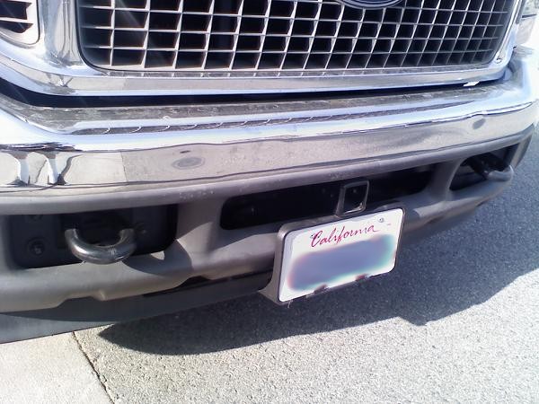

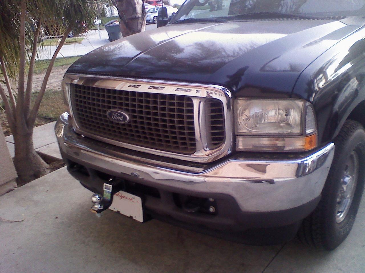

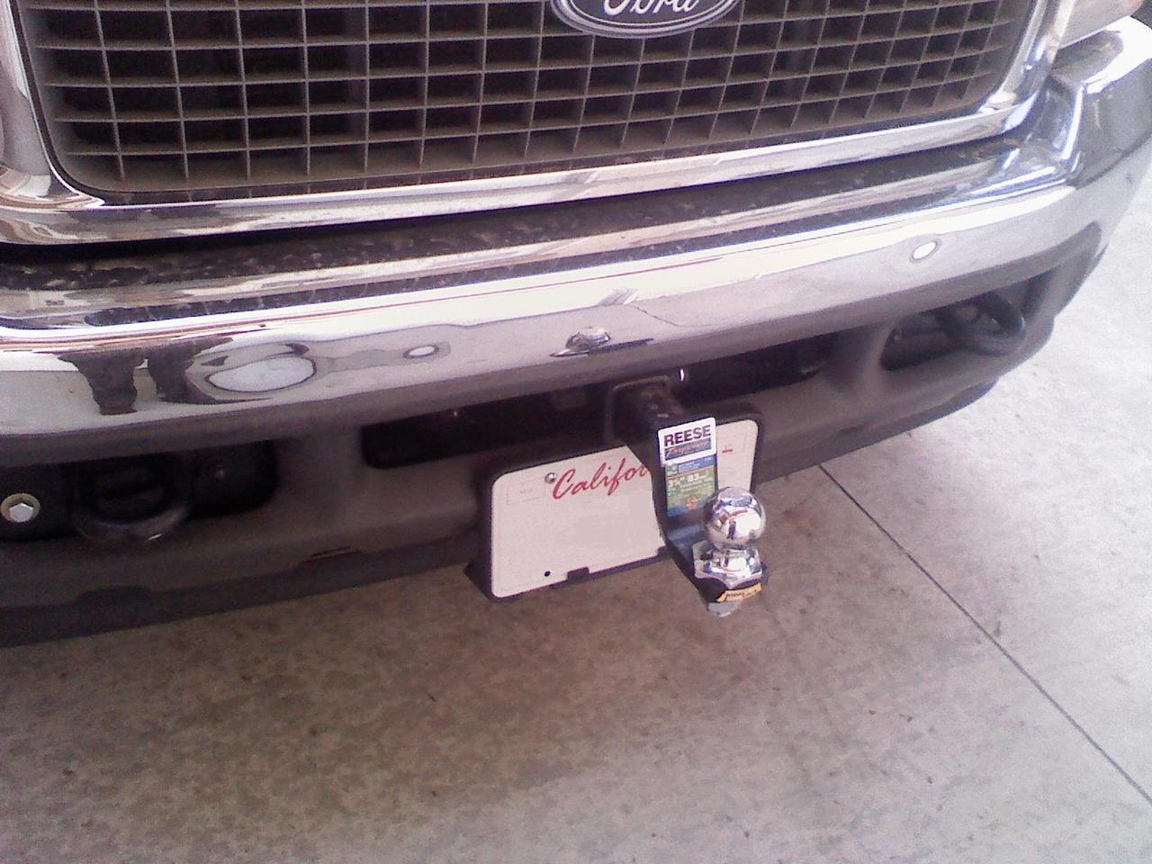

Here is what I did on my Excursion...basically same front end as F250/F350 for '00 to '04. Will probably work the same in the '05.

One thing I would recommend when you do this is to get 4 additional bolts and 2 retainers that hold the bumper in the front. The hardware they provided was a real PITA to install. If you go that route, not sure if that would reduce the tow rating. I only use it to push my trailer into a tight spot at the side of the house. Also use it for a bike rack when towing my trailer.
Attachment 68381
Attachment 68382
Attachment 68383
Attachment 68384
Thanks for the pictures.....its looks like I might be able to fab up something so I can reuse my factory fog lights....They might stick out a little more though.

I forgot to mention that you would need to also lower your license plate holder. I drilled 2 holes through the middle of the plastic holder and matching holes into the bumper. I didn't use sheet metal tapping screws, but instead used surface mount screws with nuts to fasten it. That's what I had available without making a special trip to the hardware store.
