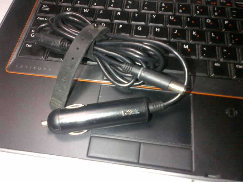

Well for my laptop I use one of these. It cost $29 when I ordered it through my rep but when you look it up online it's listed at $98 for some reason.
It's a OEM branded Comarco product. I haven't personally had an issue with the tip breaking off, but I have seen users break them.
I also had it work in a pinch with a HP Elitebook which was 19V and had the same connector. It's not supposed to work because the computer is supposed to "authenticate" the PSE.
And yeah for anything else I use the 2500W inverter, but it causes a bit of electrical noise back into the vehicle power system, and affects my radio reception.
