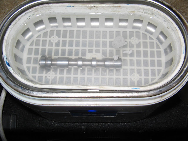

This time I had them put out, polished them with metal polish, put them in the ultrasonic clenser and clensed the shaft with a bottle brush for paintguns and benzine.

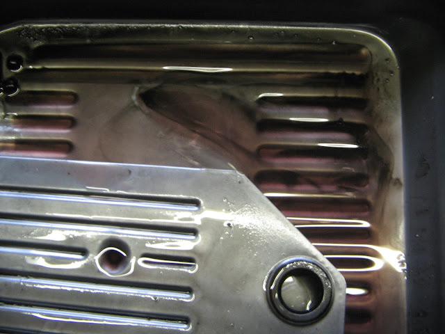

Another thing I've noticed:
At the bottom of the oil pan i putted in some neodymium Magnets and i was running the engine just for a couple of minutes and drove only in the driveway.
The magnets are covered with a lot of black stuff.
not really covered, but a lot of black stuff is at the bottom of the oil pan.
I took some pictures
One of the magnets I wiped clean th demonstrate the difference in size.
They are 5mm x 5mm x 2mm (0,196in x 0,196in x 0,078in)
The Blackness itself I don't find concerning, but the sand-like structure in the top of the picture.
But it is no sand - it also crumbled into this metallic sludge.
And the bid oil that stayed in the pan had an metallic glimmer.
Now is it just loosen dirt that had stayed in the Gearbox, because the first oil change was after 20 years or is the transmission trying to tell that a big damage is to come?
