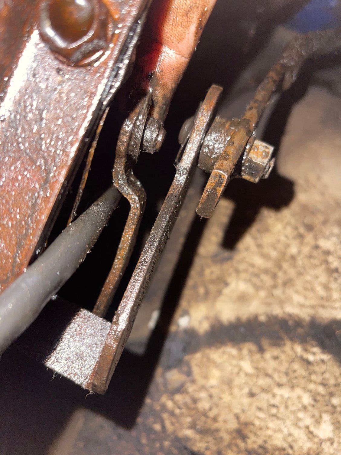

I Believe same shift linkage issue
I need some help figuring out this issue. It looks like it snapped and idk how to put it back together. Are there parts I can buy online that are easily accessible? Truck won’t shift out of park and I believe this is the culprit.
Looks like these two pieces should be connected
Old Feb 20, 2022 | 05:15 AM
XSoph's Avatar
XSoph
Joined: Oct 2015
Posts: 638
Likes: 36
From: Southwest Missouri
That nut on the far right may have come loose in the slotted end of your shift inkage. When it does that, the indexed positions of your shift indicator in the cab will be out of sync with the shift lever on the transmission housing. I would loosen that bolt just a tad more, clean all the gunk out of that area with carb cleaner, set the lever in the cab to park, slide the linkage as far up the slot as you can, and retighten it. Use a dab of locktite. If you have time and patience for it, I also replaced the washers on that slotted linkage with nordlock or wedgelock style lock washers.
