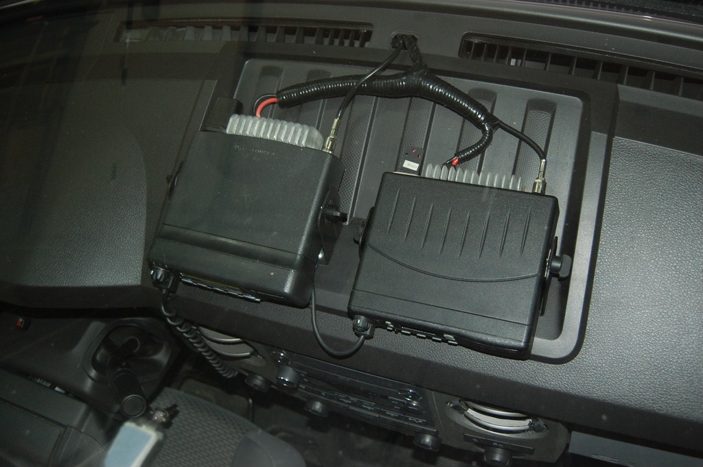

Here's my current setup with VHF and UHF mobiles. I also used to have a 29 LTD in the same place, you can read my write-up here:
https://www.ford-trucks.com/forums/1...s-to-load.html
I'm just sharing what works for me - of course you might prefer a different way but you might be able to pick out some ideas here and there from the various write ups on this forum and also the general Super Duty forum (since the 08-10 models have similar interior layouts). I work on communications systems and I use my radios all the time to check function of voice repeaters, VF data radios and sometimes as a quick tool to track interference. Then there's the 'must call' logging roads up around these parts and of course the general trucker chatter. I have found the dash tray to be a very convenient mounting location.
I mounted them with brackets and screws, short #10x1/2" ones. I have tried double sided tape, even the 3M VHB stuff which is generally pretty good but it's never been quite as solid as using screws. The last thing I need is stuff to be flying if I need to make a hard steer or braking maneuver. It can be good for testing out a few locations but adhesives start coming off on hot days and don't stick properly on cold days. Those are temperature extremes that a vehicle interior is prone to experiencing when parked.
I also considered the other plastic panels to the left and right of the air vents for cable routing, but in my case the cap in the middle was the most convenient. If there is already a light sensor it could be integrated into your wire loom - the wires that connect to the light sensor is just a pair of 24AWG wire and do have some slack in them.
