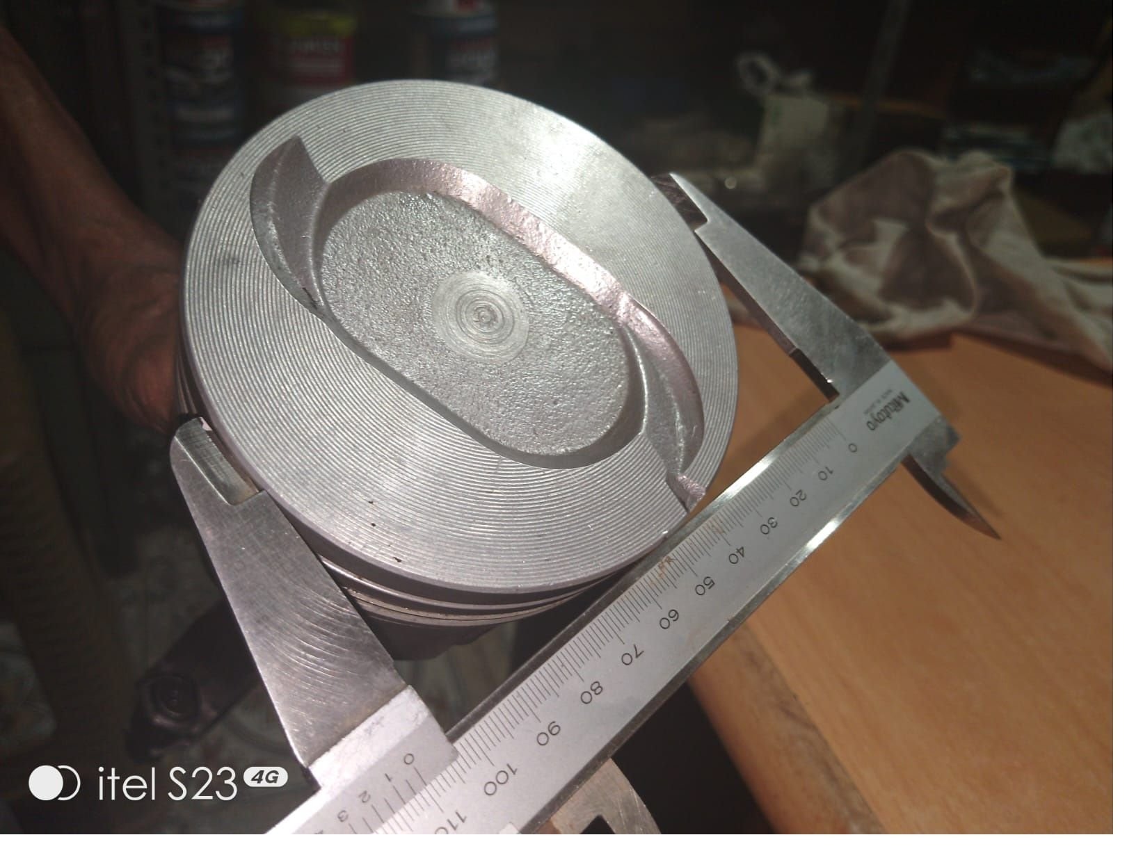

Parts for LSG-8751-6005-E
I am sorry.
My location In Indonesia Country.
I need help for identification the model , Year, catalog part and part shop for this model number and serial number for the ford engine.
We now still overhaul this engine and need the parts for
Ford Serial Number And Model Number
Spare Part need for replacement.
Piston Size, Std.
replacement.
Engine SN : 13275 H-20-RC
Model Number : LSG-8751-6005-E
Spare Part :
FUEL FILTER 1 pcs
OIL FILTER 1 pcs
AIR CLEANER 1 pcs
VALVE IN std 8 Pcs
VALVE EX std 8 pcs
KIT GASKET SET 1 SETS
MAIN AND CONNECTING ROD
BEARINGS std 8 SETS
PLATE THRUST 3 PCS
PISTON std. 8 SET
RING PISTON Std. 8 SETS
PIN PISTON Std. 8 SETS
If you have any recomendation where to buy the spareparts for that model please give me the contact email company/shop name.
I need this parts as soon as possible.
Thank you so much for your anything help.

Originally Posted by multikons
I am sorry.
My location In Indonesia Country..
Looks to be a 460 industrial application?
194-208 LSG875 Service Manual.pdf (coulsoncompression.com)
You'll get better help at that forum maybe by posting this there.
Big Block V8 - 385 Series (6.1/370, 7.0/429, 7.5/460) - Ford Truck Enthusiasts Forums (ford-trucks.com)
Thank you for reply.
Please give me the information for online shop website or market to buy the parts needs for the engine i overhaul like piston, ring piston, rod bearing etch.
Where i can buy the spare part ?
Thank you so much if you like to give me the information, this parts is very hard to find in my country.
