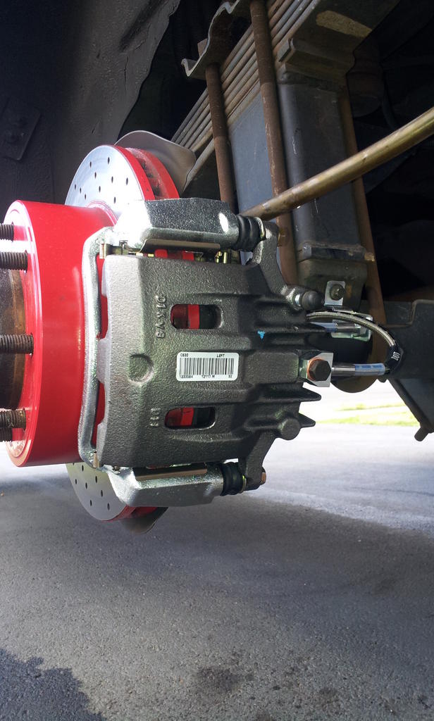

Yup, it should look like this...
Name:  rear brakes.jpg
Attachment 60020
No, that's the 01 or 02+ calipers. The 2000 caliper is ahead of the axle and the bleeder screw is in the other location.

Does anyone have a pic of the brake setup for the 2000. I was thinking of regearing and buying an axle with 4.30 gears already because its so cheap. I didnt know that there was a different setup.
