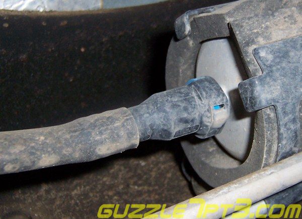

Here is a picture of the quick disconnect you need to remove at the pump by pushing on the blue tab.
http://www.guzzle7pt3.com/pics/hch/hch31.jpg
I recommend tapping on it with a screwdriver to help remove the dirt/road grime that accumulates and prevents you from removing it. You can also spray some lubricant on the connection to aid in removal.
